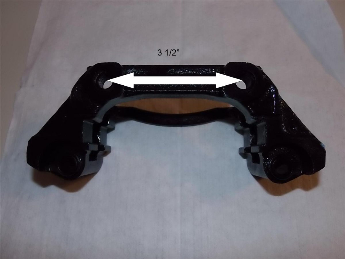

I need to know what is the bolt centre to centre dimension of the caliper bracket mounting flange that bolts to the knuckle.........

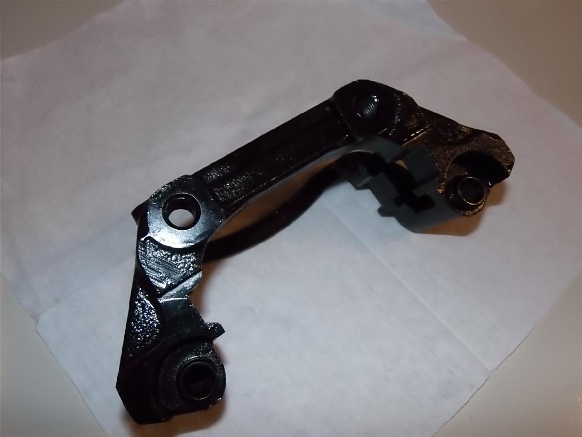

I'm doing a rear brake upgrade to my 91 and part of that upgrade is going to the 2nd design knuckle for the upgraded rear calipers. The newer design uses a more conventional fully floating caliper that is fitted to a bracket that wraps around the rotor,
As of yet I don't have a set of knuckles & I do not know what this dimension is, if anyone could help out it would be appreciated.
I'm Not using the GM rear calipers that were supplied on the cars, I'm doing a custom upgrade that will see 12" rear rotors and another set of calipers & brackets custom fitted to the knuckle.
I am on the hunt for a set of these knuckles but up here they are made of *unobtanium*, the cars just are not to be found in a salvage yard.
Any help with this would also be appreciated.
*the pic below is the bracket I will be making use of*

I don't have one off-car, but measured real quick on-car and bolt head center to bolt head center was 4''.  Hopefully someone with one off car can confirm that measurement for you.
Thx for that,
judging by the few photos I've come across of those car's knuckle...... the original caliper bracket mounts to the inboard side of the support cast into the knuckle & the support is threaded?  ..correct?
I'll have this info by end of October as I have a 96 parts car to take apart specifically for the rear brakes. I presume you'll want this info sooner but it's the earliest I can do it.
