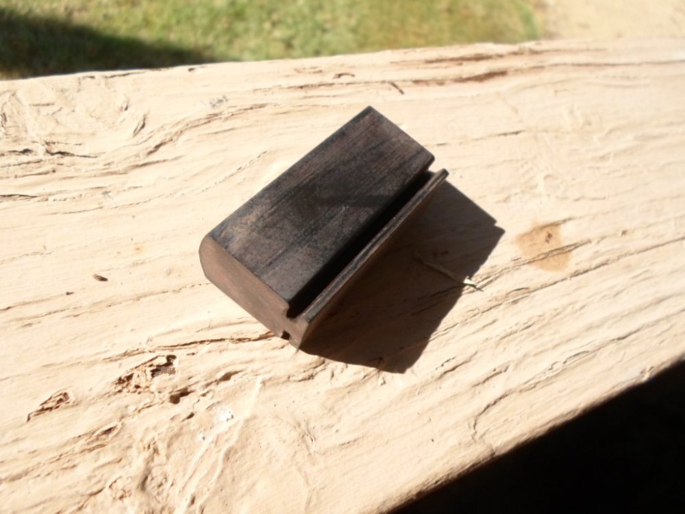

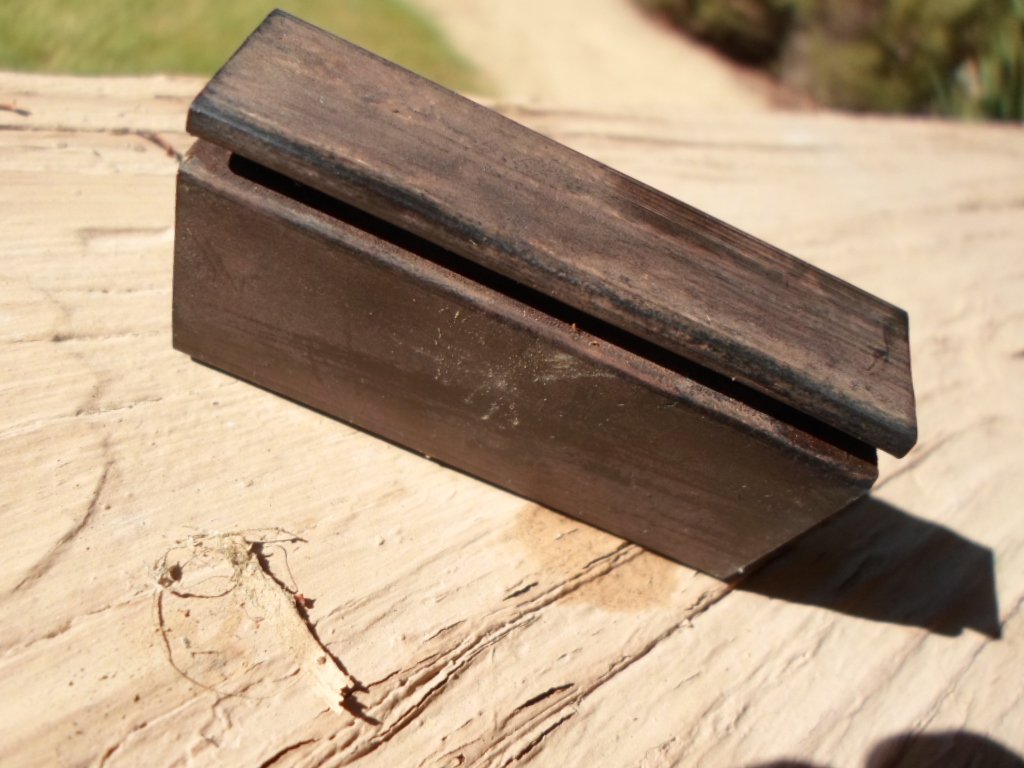

James Robert Posted September 17, 2018 Report Posted September 17, 2018 Working inside my passenger side door and found this just lying at the bottom. Does anyone recognize it? Some kind of rubber bumper, but I can't figure out where it's supposed to go. Quote
walterdude Posted September 18, 2018 Report Posted September 18, 2018 Maybe it slides into the window track and acts as a stop,,, so the window doesn't go down too far??? Good luck,,, Tom B... Quote
James Robert Posted September 18, 2018 Author Report Posted September 18, 2018 55 minutes ago, walterdude said: Maybe it slides into the window track and acts as a stop,,, so the window doesn't go down too far??? Good luck,,, Tom B... The window works fine, starts and stops in the right place, but I'll lower it down and look again. I may have to open the drivers side panel and see if I can find the same part on that side, although I was trying to avoid that extra work. Quote
Imp558 Posted September 18, 2018 Report Posted September 18, 2018 I "Think" it goes on the bottom of the roller track so the roller track doesn't bump the bottom of the door, it's been a while since I was in there. Quote
James Robert Posted September 18, 2018 Author Report Posted September 18, 2018 11 hours ago, Imp558 said: I "Think" it goes on the bottom of the roller track so the roller track doesn't bump the bottom of the door, it's been a while since I was in there. Bingo! You're right, it slides into a bracket at the bottom of the window roller track. I could only see it with the window half way down. Thanks, you guys are great! Imp558 1 Quote
