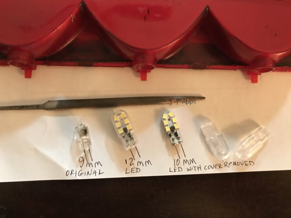

jmjp5055 Posted September 29, 2018 Author Report Posted September 29, 2018 Update changed out high mout brake lights from halogen to led wasn’t that difficult , I’m posting pics, hardest part have to file a 1/2 mm. Notch, on top and bottom of light port, also replaced O rings Quote
