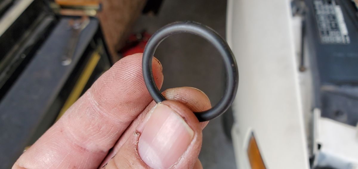

jiggity76 Posted June 6, 2020 Report Posted June 6, 2020 On 9/9/2018 at 10:49 AM, 55trucker said: Not being able to see what you're referring to .. the only O-ring that would be included in the kit would be the coolant bypass O ring that is between the plenum & the intake... it is to the rear of the coolant thermostat housing, right under the throttle body Ah, so this is the O ring for the plenum to intake area that was in my gasket kit. Thanks 55! Quote
