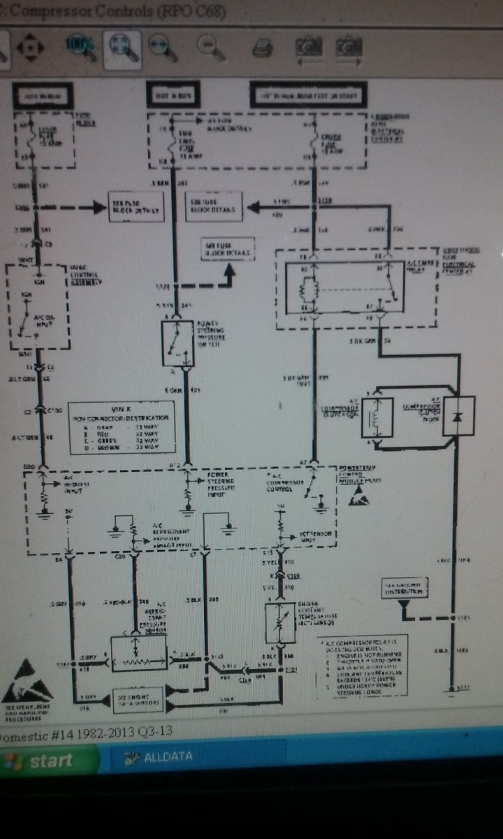

Imp558 Posted August 29, 2018 Report Posted August 29, 2018 Don't jump the switch, we misinformed you. That one has an actual sensor. I have to dig through Alldata and draw a diagram for Mitchell tonight, I'll dig around in the Cutlass prints and put together a diagnostic ritual for you. You're going to need a multimeter with resistance and DC volts though. Quote
vipmiller803 Posted August 30, 2018 Report Posted August 30, 2018 Ah thank you Tom for looking that up. I'm used to the simple two wire in line switches on mine. Hmm might need to actually test the sensor. If there's a resistance the pcm is looking for, you could use a resistor on the correct pins to fool it temporarily. I'm no help there though, as I do not know the correct resistance or the pinout of the connector. Quote

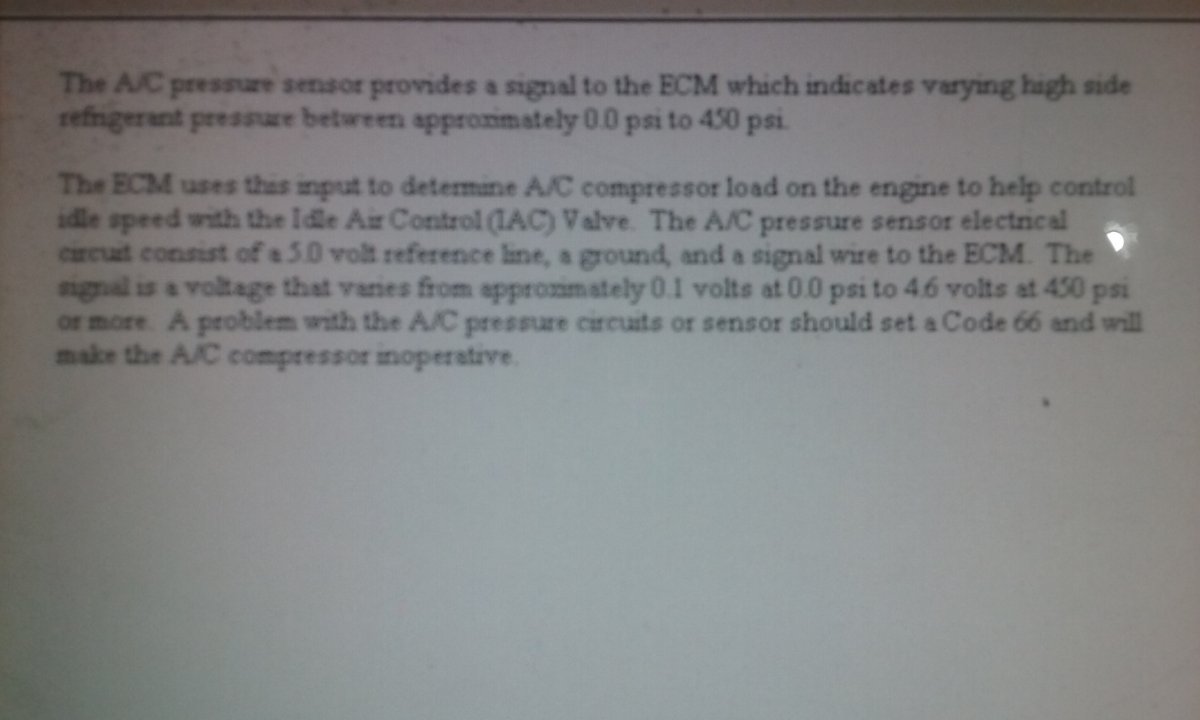

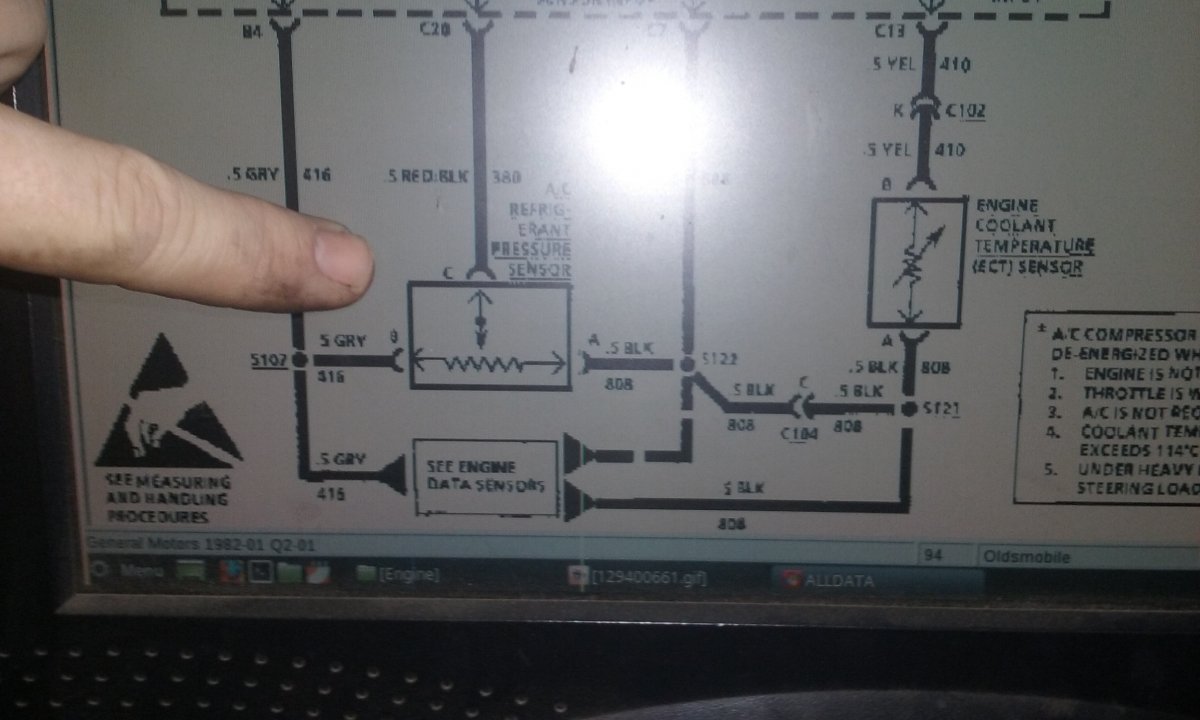

Imp558 Posted August 30, 2018 Report Posted August 30, 2018 It would be a voltage between 0-5 on the red&black wire but I can't find a threshold or truth table. Quote

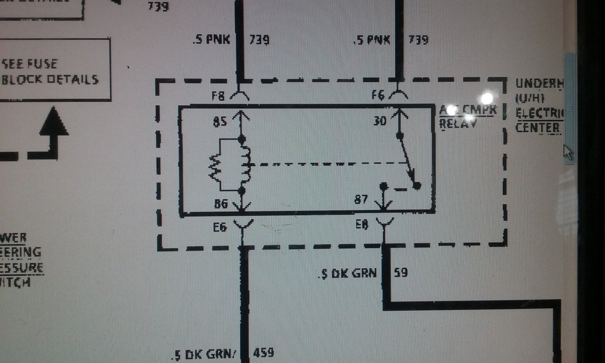

Imp558 Posted September 2, 2018 Report Posted September 2, 2018 I see a few things you can test here. Jumping pin 30 to 87 on the relay socket will engage the clutch, if it doesn't the clutch, fuse, clutch ground, or wire to the clutch is the problem. Also you can slide a sewing pin alongside the red/black wire on the pressure sensor and read the voltage, it's 0-5v so if you know how many pounds of refrigerant you put in it shouldn't be hard to figure out the scale of the voltage. And make sure the car has no codes. Quote
Leadfoot Posted October 16, 2018 Author Report Posted October 16, 2018 I jumped the relay and the compressor engaged. No cold air. I tried using the needle across the green and black wires coming from the compressor (didn't see red/black) and got 0v. When looking on Rockauto I see 2 switches listed. Is there a simple way to figure out which one I have? Quote
