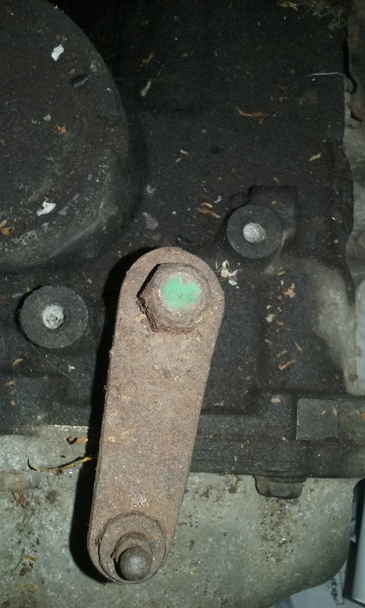

Is there an adjustment on the neutral safety switch? My car was starting in park now I have to have it between neutral and overdrive and also my reverse lights come on when it’s in neutral, is there a adjustment on these or is it just time to replace it
There's a bit of slop in the holes but not that much.
You probably lost a mounting bolt, there's only two.

I ordered a new one, both of the bolts are there for it. Maybe it’s just time for it I’m having to do one in my k5 blazer too

GM glued some of the plugs into them with wax on the trucks, if yours is like that a hair dryer will soften the wax.
Mine is bolted directly to the column in the blazer, I bypassed it at the moment in it. Hopefully this new switch will fix the one that’s in the lumina
