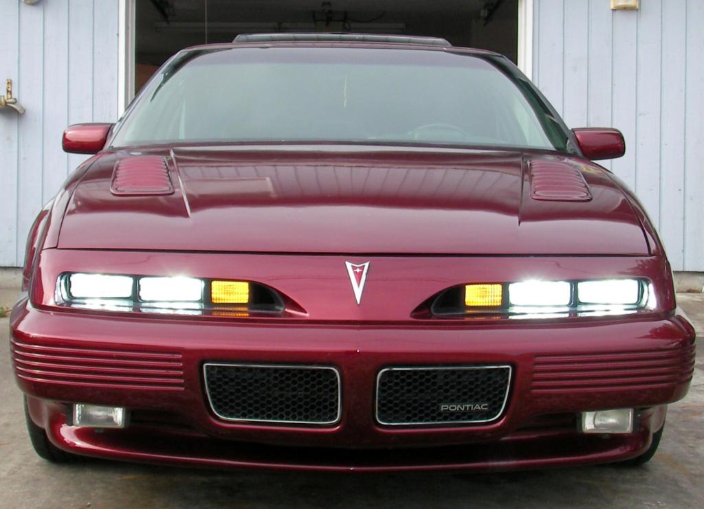

crazyd Posted July 26, 2018 Report Posted July 26, 2018 Done the mini-quad LED upgrade on my '92 GTP. I used Opt7 (USA) off Amazon, 6K, 7000LM (3500/ea) in the lows and 8400LM (4200/ea) in the highs. Contrast that with about 1200LM on the HIRs. I think they were about $89/pr for the lows, and $109 for the highs. Obviously not the cheap route, about as expensive as you can buy on Amazon, but at $200 complete still way less than an HID upgrade. I had already done 9011/9012 HIRs in the housings back in 2013, so it was drop-in. You have to remove the existing bulb without damaging the housing itself. Then you need to rotate the new ones in the housing until the beam looks its best, and use hi-temp silicone (preferably the copper stuff) to secure them in place. What I found is you're better off finding (or buying) two more low-beam housings. They're rare to find good ones that aren't chipped or cracked in the junkyard, and matching two is even rarer. Depends on your patience and whether you care if they match. Only a handful of cars ever used them besides W-bodies. '93-97 Camaros also did. After 4 years with HIRs, I can say with complete and utter awe that the LEDs are jaw-droppingly better than the HIRs were. They are awesome once they're properly aligned and aimed. Especially the way they light up reflective signs, it's incomparable to incandescent. Pic below from a previous post. ss427 1 Quote

Tru2Chevy Posted August 5, 2018 Report Posted August 5, 2018 If you want to convert to HIDs properly, there is at least one kit out there (made specifically for 93-97 Camaros, but should fit the same): https://www.blackbirdlighting.com/camaro93-97.php It's definitely not a cheap solution, but (full disclosure) I know the owner of Blackbird Lighting, and the owner of the blue Camaro in those pictures, and the light output is outstanding. - Justin Quote
