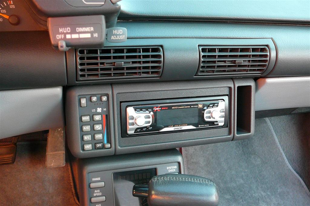

55trucker Posted July 14, 2018 Report Posted July 14, 2018 a simple Scosche kit is what is in my car, the Alpine unit is flush mounted, but it is in there tight, the RCA plugs are 90 degree facing down to clear the heater assembly. Quote

Brodizzle83 Posted July 14, 2018 Author Report Posted July 14, 2018 a simple Scosche kit is what is in my car, the Alpine unit is flush mounted, but it is in there tight, the RCA plugs are 90 degree facing down to clear the heater assembly.Do you happen to have a picture? Sent from my SM-G955U using Tapatalk Quote
55trucker Posted July 14, 2018 Report Posted July 14, 2018 yeah, it's in my gallery, this is the old head unit that was in the car, but the kit is the same one Quote
Brodizzle83 Posted July 14, 2018 Author Report Posted July 14, 2018 yeah, it's in my gallery, this is the old head unit that was in the car, but the kit is the same one Hmmmm...I gotta find that kit! Is this the one? Sent from my SM-G955U using Tapatalk Quote
55trucker Posted July 14, 2018 Report Posted July 14, 2018 Yikes!, that was almost 20 years ago, ask me what I had for breakfast yesterday? lol I remember the kit was a single din install package, it had multiple faceplates for the install because the *usual* method was to install the faceplate that projected the head unit outward to get the clearance at the rear. I didn't want that so I selected the faceplate that supported the old style 70's two knob radio insert that fit into the middle, I omitted that insert & set the head unit with it's trim ring directly into the centre of that faceplate. This is what that kit looked like.....Scosche might not even support that old kit anymore https://www.amazon.com/harness-installing-Single-Radio-PONTIAC/dp/B0147PP9J0 Brodizzle83 1 Quote
