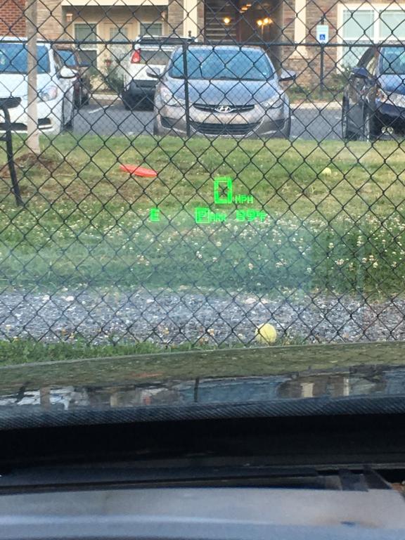

mechanic58 Posted July 8, 2018 Report Posted July 8, 2018 Previous owner says the flap or shudder mechanism is broken. When you look down into the cavity through the windshield you can see a small spring laying down inside there. How hard is this to get to? Quote

mechanic58 Posted July 14, 2018 Author Report Posted July 14, 2018 Got this apart. The adjustable mirror mounts broke off (plastic). They are replacable. I wonder if one can buy parts for these? Quote

mechanic58 Posted July 15, 2018 Author Report Posted July 15, 2018 Welp, this is fixed. Made some parts instead. digitaloutsider 1 Quote
