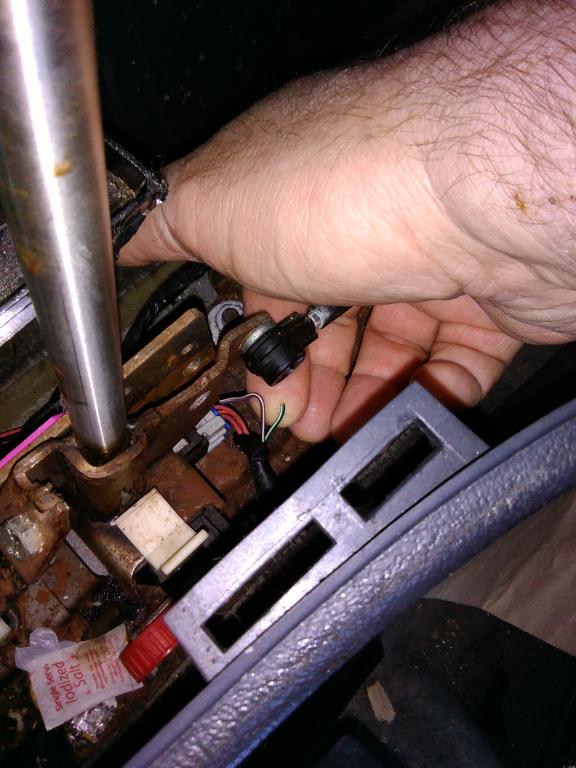

98gpgt Posted July 8, 2018 Author Report Posted July 8, 2018 Could this be the whole problem? Both green-white and purple-white wires are detached. Quote

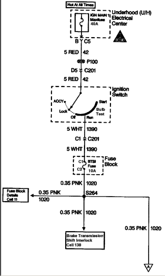

rich_e777 Posted July 8, 2018 Report Posted July 8, 2018 Its possible but we need to know what those wires are for, Ive got a manual around somewhere that should have the schematics. Quote
cheatah faheatah Posted July 8, 2018 Report Posted July 8, 2018 I think all your trouble can be traced back to that packet of salt.....lol. Imp558 1 Quote

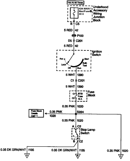

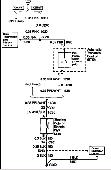

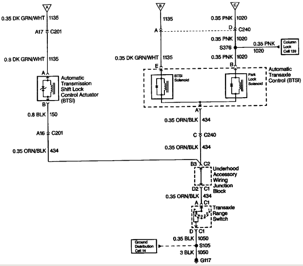

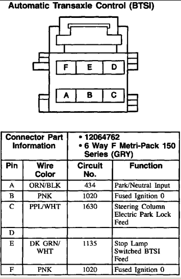

Imp558 Posted July 8, 2018 Report Posted July 8, 2018 I'm out today, I'll post the schematics later this evening and we'll see what those two wires are. Looks like Green/White, Violet/White to the shifter? Quote
Imp558 Posted July 9, 2018 Report Posted July 9, 2018 Those two wires are nothing to do with this, they are the sterring column lock and the solenoid that keeps you from shifting out of park without stepping on the brakes. I'd jump that starter or jump a wire from the battery to the little purple wire on the starter to see if the starter works. Quote

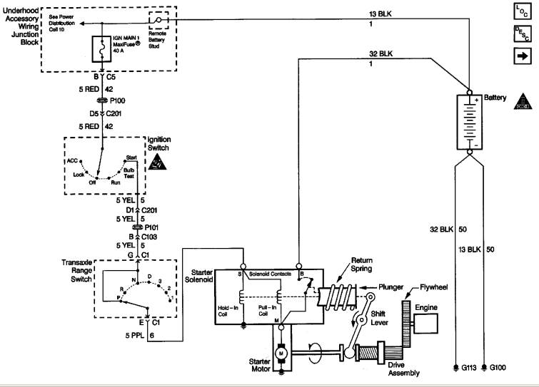

Imp558 Posted July 12, 2018 Report Posted July 12, 2018 There's two studs with wiires, just touch a screwdriver across them. It'll make a spark and hopefully the engine will turn over. If you touch the engine with the screwdriver it'll make a big bad spark so be careful only to touch the two terminals with the screwdriver. Quote
98gpgt Posted July 19, 2018 Author Report Posted July 19, 2018 I'm back. There's 2 large studs on the solenoid, and a smaller 1, all 3 have wires. I'm looking at this: https://m.youtube.com/watch?v=Mv0zjxp6654 and he's saying hot (red, larger stud) goes to a smaller wire/stud?, but it's not clear what he has. I put a test light on all 3 lugs, and see nothing. I have the starter now, but it may not even be that ... OK looked at the Haynes manual, the smaller terminal is what you have to short to the juice terminal (red), i take it. Wondering if there's even anything getting to the starter. Maybe a fusible link if that's the case? Quote
55trucker Posted July 19, 2018 Report Posted July 19, 2018 The terminals you are concerned with are the large *battery* stud that your heavy wiring is connected to & the small ign/solenoid terminal. The 2nd large stud (close to the main body) is the contact stud that along with the 1st heavy stud *closes* the circuit to the armature inside the starter, those two make & break via a round contact disc that moves back & forth along with the iron core inside the solenoid. One turns the key, the solenoid windings ground, the electromagnetic field moves the core, the contacts close, the armature begins to spin & the *bendix* drive on the back end of the armature shaft pushes the gear out into the flywheel gear. If the solenoid windings have failed or the contact disc has worn away there will one or two responses when one *shorts/bridges* the solenoid terminal to the the large battery terminal, 1. no response 2. the solenoid closes, the the armature does not spin but you hear the bendix drive moving. Quote
