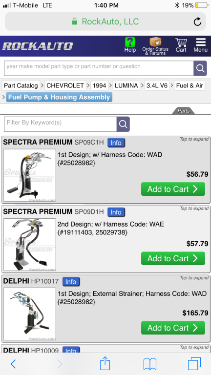

NCTyphoonKid Posted May 13, 2018 Report Posted May 13, 2018 Is there a difference in the harnesses for z34 fuel pumps? My gauge is off and I plan on putting a new sending unit in when I drop the tank and noticed rockauto lists two different ones, is the difference just wiring or is there more to it? Is there a easy way to tell without dropping the tank first? Quote
digitaloutsider Posted May 13, 2018 Report Posted May 13, 2018 Maybe you can get up under the car and see if you're lucky enough to still have a wiring harness tag on it? The difference seems to be one is 4 amp vs 6 amp. Since RockAuto lists the OEM part numbers, you could probably go to the dealer and see which one they say is right and go off that. Sometimes you'll see a VIN # reference for midyear changeovers like that, but I can't find one anywhere. Quote
NCTyphoonKid Posted May 13, 2018 Author Report Posted May 13, 2018 I’ll see if I can crawl under it and look, the pump is getting weak I believe I have to step on the gas a little to get it to start now and with the gauge being wonky I’ve about ran it out of gas twice so I’m sure the pump is getting close to being toast, and I’m not sure how old it is anyway. But even before I did that it would take 2-3 starts to finally get it to run.im assuming from age Quote
Imp558 Posted May 14, 2018 Report Posted May 14, 2018 I wonder if a dealership would be willing to give you the P/N based on the VIN.. Quote
NCTyphoonKid Posted May 14, 2018 Author Report Posted May 14, 2018 I slid under it tag was still in perfect shape I had a WAE one. So got the replacement pump, sending unit and fuel filter on the way. Going to try running it down on gas in the next couple days and get it ready for replacement. Imp558 and digitaloutsider 2 Quote
