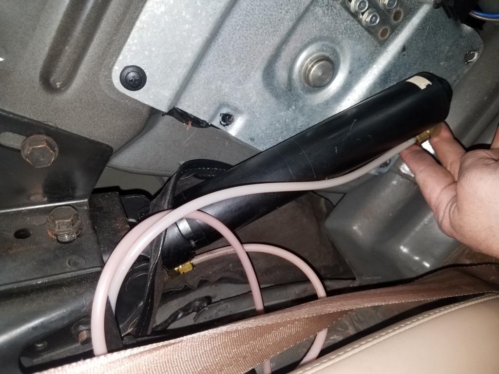

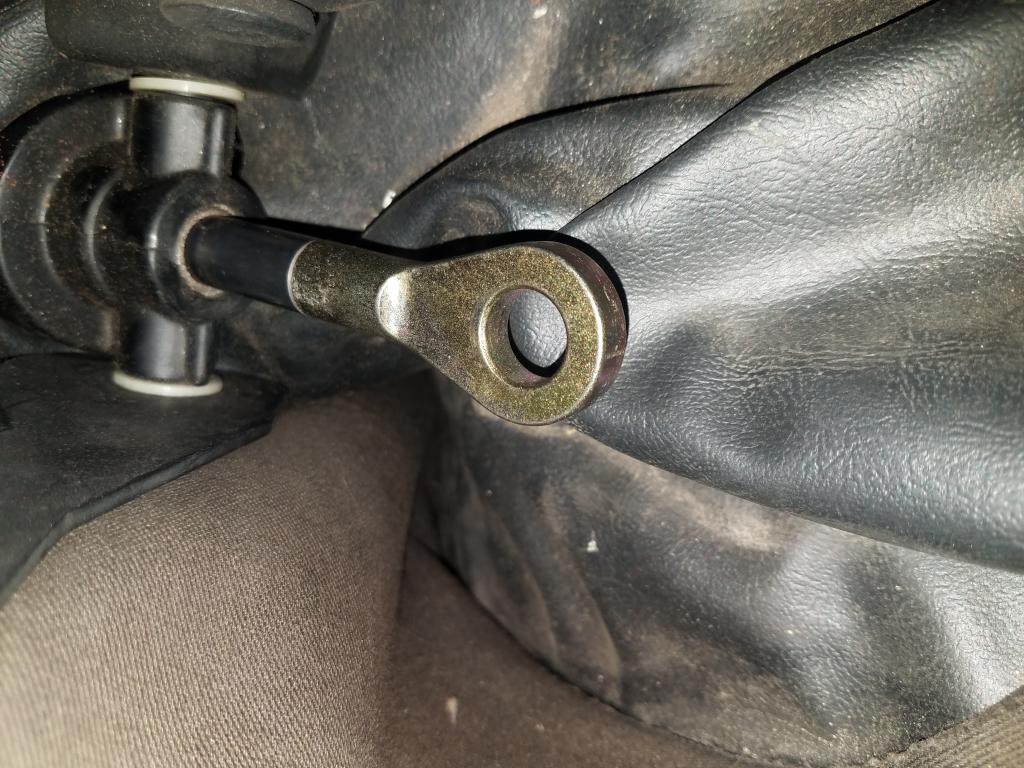

Hi eveyone has anyone had this same issue trying to get the brass part of the cylinder to align with the frame? It seems like its under pressure and stuck to the piston cylinder. I took it off like an idiot last year and now im trying to put it back together for my top isnt going up without me using my own strength. Any help would be appreciated.
Stick a big screw driver through the hole from the bottom to rotate it. It should also pivot up and down at the pin. To extend, use the up/down button for the convertible top.

Thanks 4 your reply. I push the top botton and it did the job. Thumbs up
