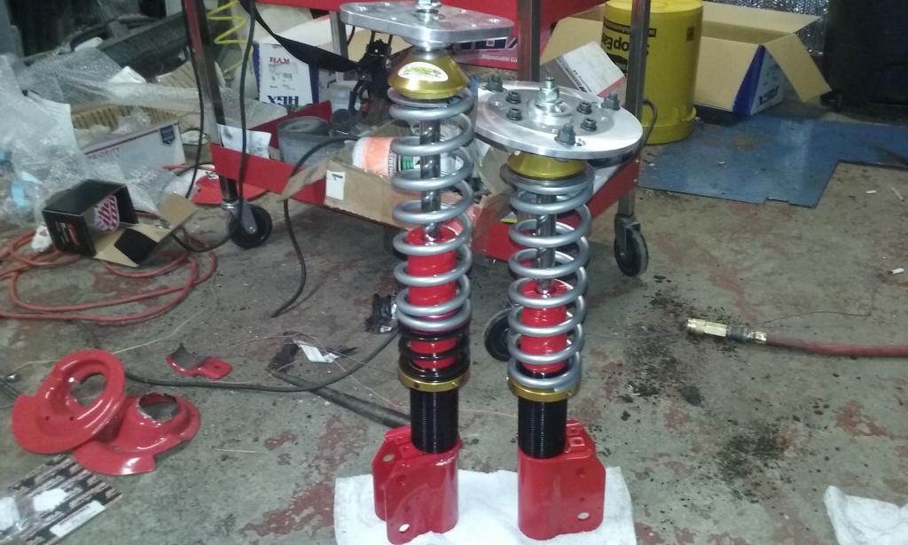

I posted this in my GS thread, one rear and one front. I just ordered the other two springs and bumpers last night. I actually disassembled them after this picture so I could put those plastic tubes back on them until I'm ready. The adjustment things on the ends of the shafts are plastic and don't look durable. One is already a little tweaked just from shipping so the tubes are protecting them.

Just a quick update, those bumpers above should fit on any strut, a little wd-40 and a couple whacks with a hunk of pipe and hammer and they're on the shaft.

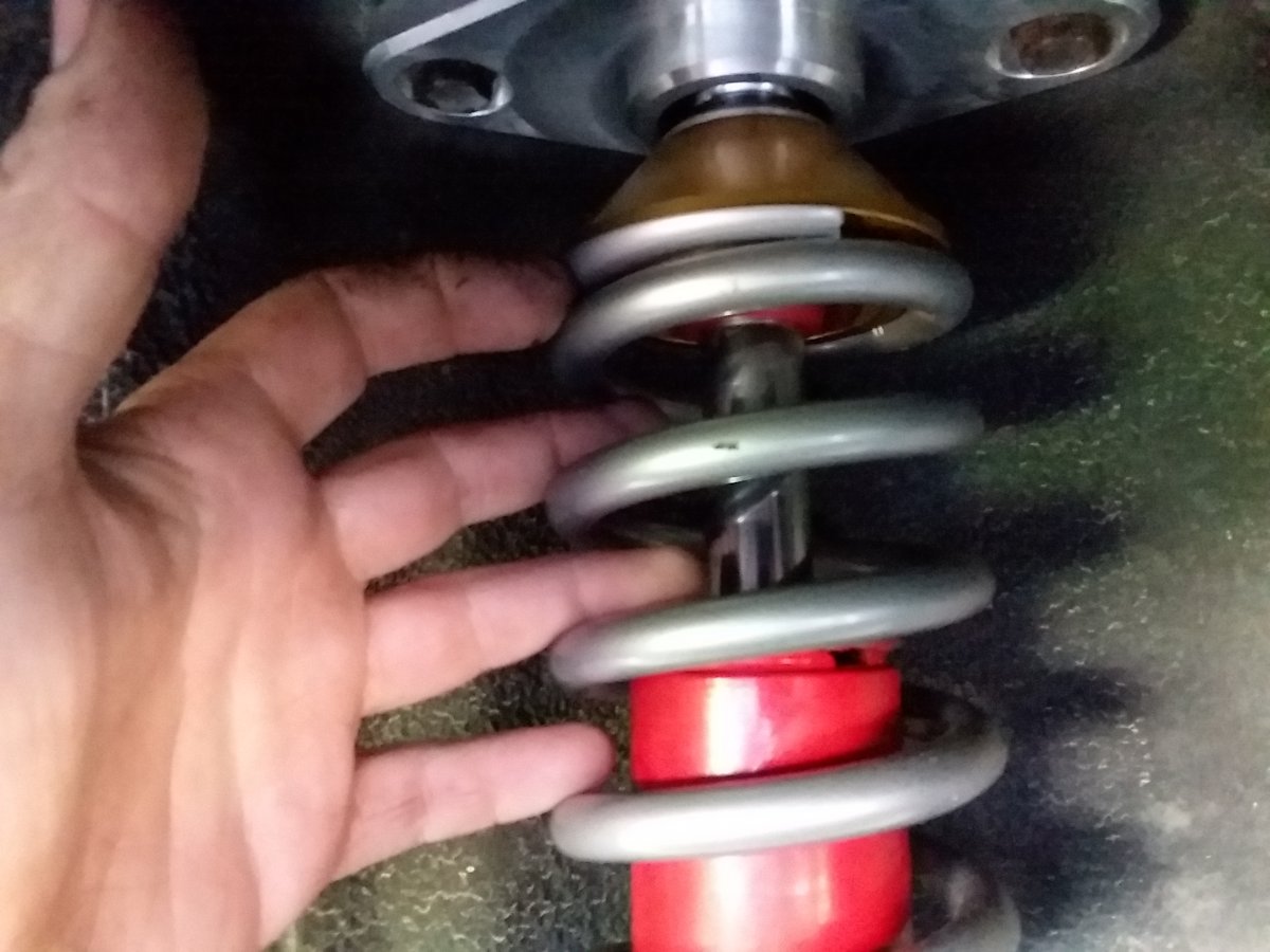

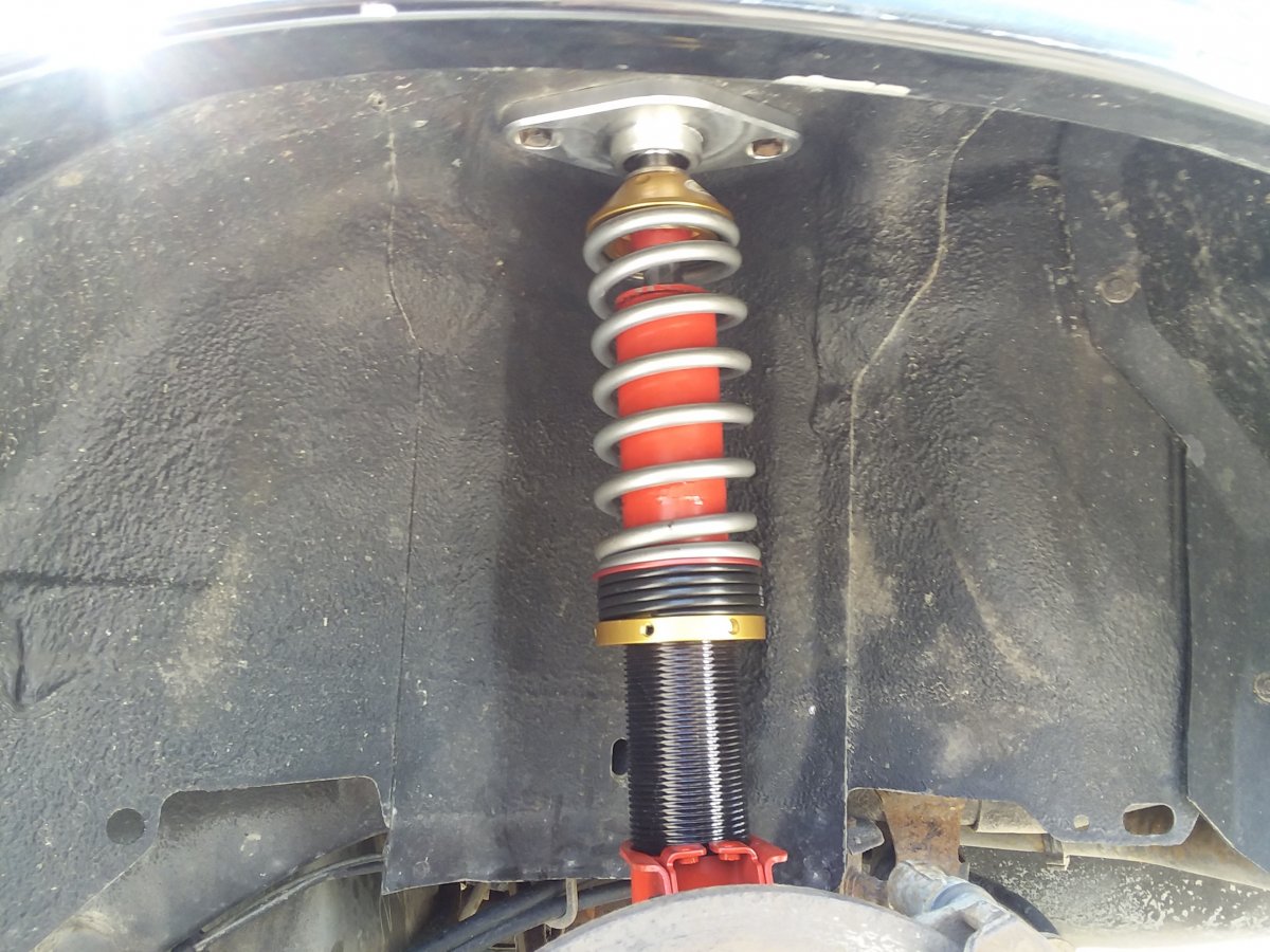

In the first picture is my 225# rear spring with about 1.5" of suspension travel.  I'm going to order some 12", or maybe 14" springs but for now I stuck the front 325# springs in the back and got about 3" of travel in the second picture. The 325# springs are very firm, almost mining cart kind of firm but honestly I think I like it.
I may do some longer 300# springs in the back and maybe 400# up front but I'm gonna drive this for a week and mull it over.

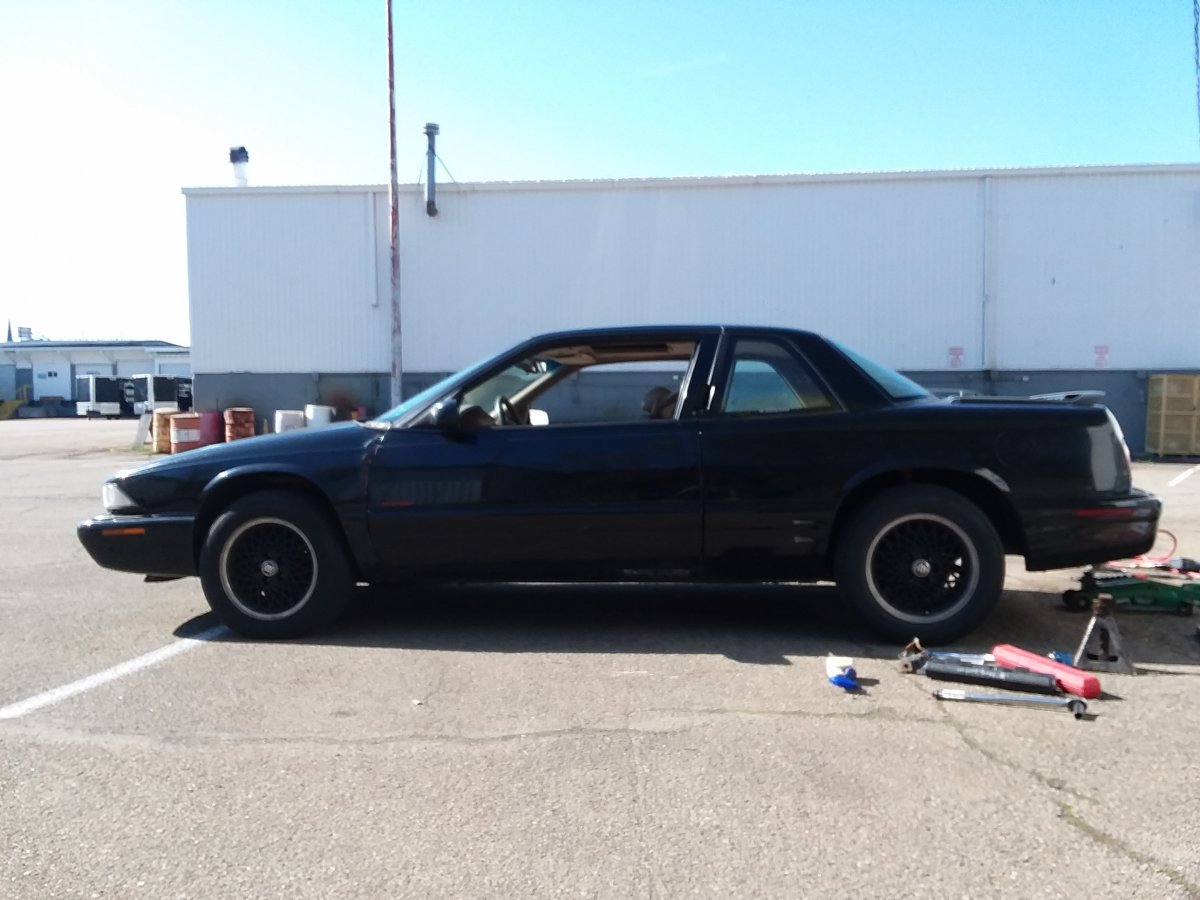

I'm bumping this instead of making a new thread. For reference but also because I have to do the rear coil over as a necessity. My rear sags to the point that the wheel is cambered in at top. I will post a picture of it later.
