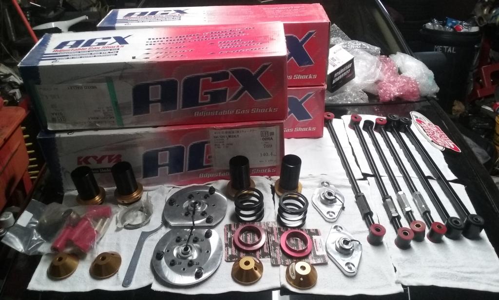

Imp558 Posted April 28, 2018 Author Report Posted April 28, 2018 (edited) Took a couple inventory pictures today so I can see what else needs ordered. That's a LOT of bad-ass for one picture! So far I see springs, isolators, the tube isolators to keep the springs from wrecking the threads on the sleeves, and another set of bushings since I cannot find the missing one for that lat link. Edited April 28, 2018 by Imp558 rich_e777 and Mach 5 2 Quote

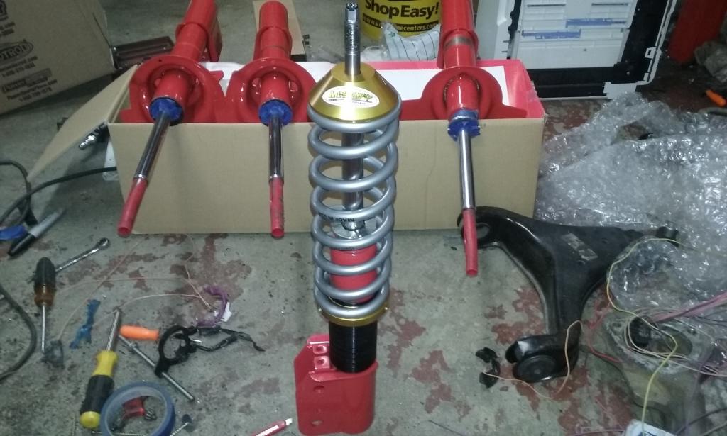

Imp558 Posted May 5, 2018 Author Report Posted May 5, 2018 I'm a little surprised how well that worked. Can't get the plates on top yet, the lower bushings are a few thou too tight. No biggie, a few seconds with a flapper and it's all done. Just three more to go! rich_e777 1 Quote
GTP091 Posted May 5, 2018 Report Posted May 5, 2018 What is the purpose of the bell shaped thing on the 3 struts you have sitting on the cardboard box.? It looks like the upper bearing plate from a front strut has been welded on the rear strut? Quote
Imp558 Posted May 6, 2018 Author Report Posted May 6, 2018 Those were spring seats. My car is running second gen suspension. Quote

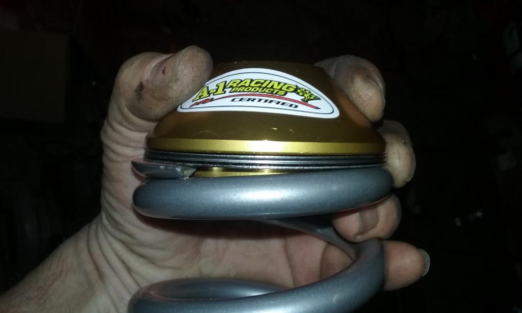

Imp558 Posted May 6, 2018 Author Report Posted May 6, 2018 Am I correct in thinking the spring's footprint on the bearing is shit and there should be an isolator between them? Quote
Imp558 Posted May 6, 2018 Author Report Posted May 6, 2018 no isolator needed. Okay cool. I may add them later if vibration becomes an issue but ultimately this is getting a built, intercooled L67 with 2 1/2" exhaust through a Thrush Welded series muffler and a Walbro 255 fuel pump. Where vibration noise is concerned I suppose I need to choose my battles. Quote
