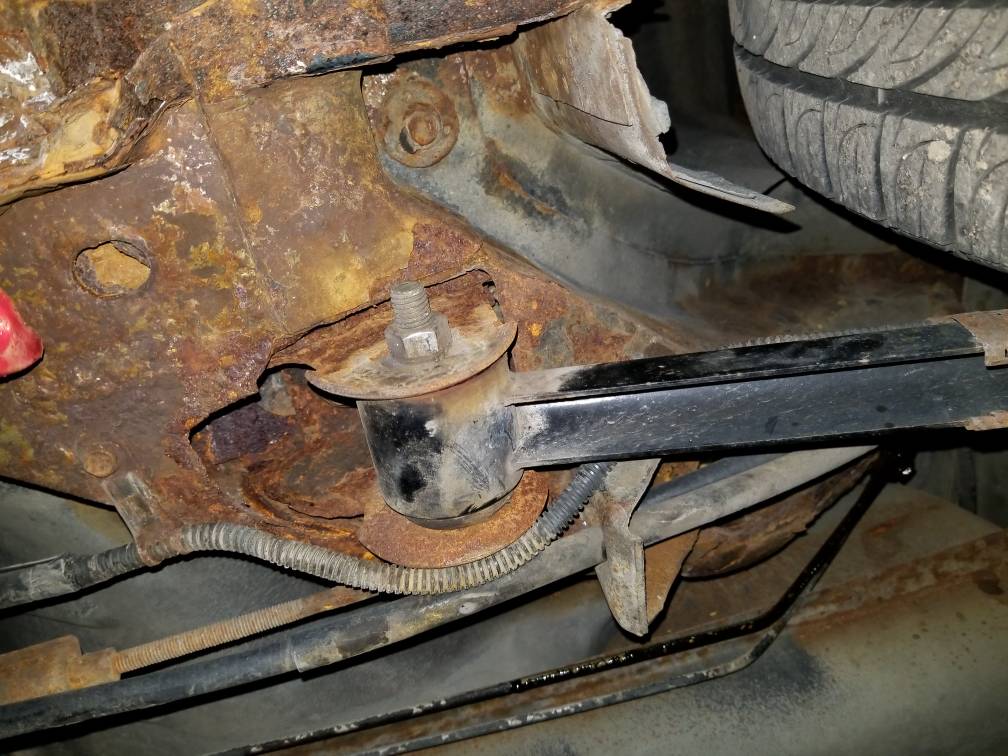

I suspect the vibration from the rear is being caused by the severely rusted out mounts you showed in your other thread.  To be honest, I wouldn't worry about struts until you're able to repair the damage.

I also replaced my trailing arms and rear leaf spring isolator pads.   Your original rubber leaf spring isolator pads may be gone.  (Rockauto calls them "leaf spring bushings" and "leaf spring insulators" depending on whether you use plastic or rubber).
