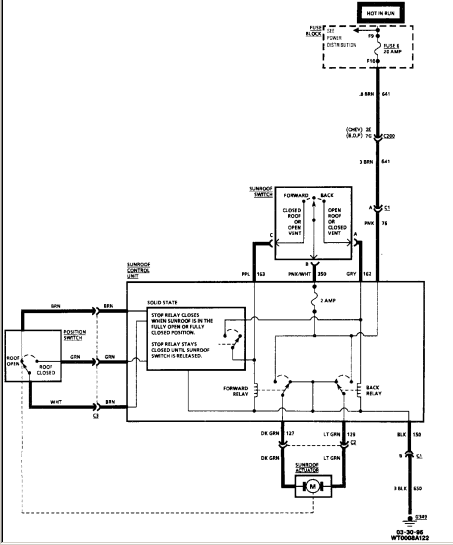

Brodizzle83 Posted May 21, 2018 Author Report Posted May 21, 2018 Bummer dudes...the way I tested the old motor was wrong. I plugged the old one to the 18v Ryobi battery and it worked. I re-tested it because I plugged the "new" motor into the car and hit the button before I installed it and it didn't work. All that happens is the relay clicks. Maybe it's a bad relay? Sent from my SM-G955U using Tapatalk Quote
Imp558 Posted May 21, 2018 Report Posted May 21, 2018 What clicks? Didn't you say the motor was clicking? Quote
Brodizzle83 Posted May 21, 2018 Author Report Posted May 21, 2018 It's the relay that's clicking...the black plastic box to the left of the motor. I couldn't tell what was clicking with the headliner installed. Sent from my SM-G955U using Tapatalk Quote
55trucker Posted May 21, 2018 Report Posted May 21, 2018 It's not just a *relay*, there are two relays inside the control module, one is the *forward* and the second is the *back*. Seeing as the replacement motor you purchased is working I have to believe that the module has failed. Did you verify that you have voltage to both the switch & to the module as well as out of the module to the motor? Quote
Brodizzle83 Posted May 21, 2018 Author Report Posted May 21, 2018 No, I haven't checked any of that. To be completely honest, electrical is my least knowledgeable topic in the automotive world. I have no idea how to check that stuff. It's a little embarrassing, but also the truth. Sent from my SM-G955U using Tapatalk Quote
Imp558 Posted May 21, 2018 Report Posted May 21, 2018 Clean all the connections, and verify power. Quote
Imp558 Posted May 21, 2018 Report Posted May 21, 2018 I'll post some schematics tomorrow Brodizzle83 1 Quote
Brodizzle83 Posted May 22, 2018 Author Report Posted May 22, 2018 I'll post some schematics tomorrowThanks man, I appreciate all the help from everyone. This is by far my favorite forum ever! So many people willing to help each other out! Sent from my SM-G955U using Tapatalk Quote
Imp558 Posted May 23, 2018 Report Posted May 23, 2018 That relay box is a bit complicated, now you have the power and position switch parities. Brodizzle83 1 Quote
Brodizzle83 Posted May 23, 2018 Author Report Posted May 23, 2018 That relay box is a bit complicated, now you have the power and position switch parities. 96gpmoonroof.PNG Sweet! Thanks man, appreciate it! Sent from my SM-G955U using Tapatalk Quote
