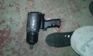

Imp558 Posted May 5, 2018 Report Posted May 5, 2018 I agree changing the balancer is a better option. Cheaper, less strain on a single belt, and replace the CKP (it's going to happen anyway at some point). I use a big Impact that I call Boudica. I replaced many with a big ratchet and a hammer before Boudica so while a beast impact is easier it's certainly a task that can be completed without one. Quote
Galaxie500XL Posted May 5, 2018 Report Posted May 5, 2018 I don’t have a big impact wrench, so when trying to break the pulley bolt loose, I use the rope trick...cotton or nylon rope fed into the cylinder through the spark plug hole, then turn the engine until the rope compresses against the combustion chamber, then remove the bolt. Quote
