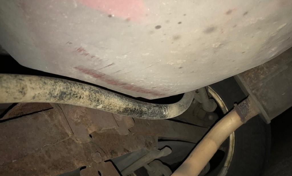

oldmangrimes Posted February 14, 2018 Report Posted February 14, 2018 (edited) Last year I bought a used rear sway bar and brackets to upgrade my 95 Cutlass convertible from a junkyard using car-part.com. They said they were from a 95-96 Monte Carlo Z34. I measured the rear bar as 20mm (I checked again last night), it was much beefier than the flimsy little bar that came on my convertible. Although it came with the bushings still attached to the bar, I bought new bushings for it. I think I paid around $100 for everything, including shipping. My car corners much much flatter, feels stiffer, and can even oversteer a little, which can be a surprise if you're not ready for it. It didn't fit perfectly, it was hard to install (although that could have just been me being an idiot). It doesn't hit the single exhaust from the 3100, but it sometimes rubs the back of the spare tire well. I attached a picture where you can see the rub marks. My car has been hit in the rear, and has 225k miles on it, and has had much of the rear suspension replaced by an amateur (me!) and never professional aligned, so maybe my situation is a little unique. Even though it's not perfect, I am very happy that I did it. I feel the difference 100 times a day. I recommend it. Edited February 14, 2018 by oldmangrimes ManicMechanic 1 Quote
bluecalais79 Posted February 15, 2018 Author Report Posted February 15, 2018 Wow that is a huge bar for sure. I myself am going to be ok with getting a 14mm for the bottom and the top brace I just acquired, couple that with some KYB's to replace the noisy Moog's I had installed (this was a rush job as my original GM"s were literally rotting off the car and I didn't do enough homework on the Moogs), and call it a day. As previously mentioned I've got the Vert STB in the front which immensely helps, so all around this will be a decent handler. I'll mention what also helps. I weeded it down to figure out my 96 is a Series III car so I got the Variable Effort steering in it (standard in the Series III and Series IV in 1996) which is HUGE. Quote
