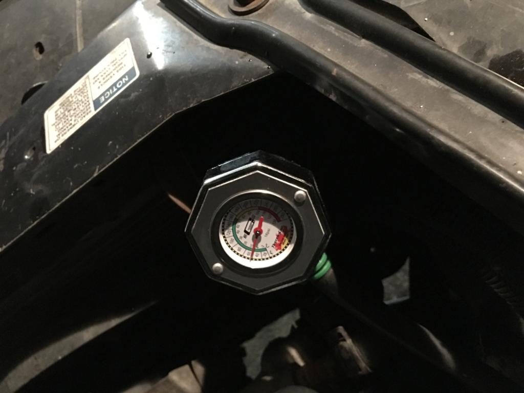

NCTyphoonKid Posted February 3, 2018 Author Report Posted February 3, 2018 Got this at the parts store to try and help isolate some of the coolant temp and figure out what’s really going on. It was inexpensive and looked like it would help Quote
Imp558 Posted February 3, 2018 Report Posted February 3, 2018 Hopefully the pressure rating is correct for the application. Quote
NCTyphoonKid Posted February 3, 2018 Author Report Posted February 3, 2018 Hopefully the pressure rating is correct for the application. It was 16psi like the cap I took off Imp558 1 Quote
Imp558 Posted February 3, 2018 Report Posted February 3, 2018 It was 16psi like the cap I took off That thing is pretty cool. Quote
NCTyphoonKid Posted February 3, 2018 Author Report Posted February 3, 2018 That thing is pretty cool. For 30 bucks it seems useful and I’m driving the car now and the gauge is fluctuating and I stopped and checked the temp on the cap and it says I’m not overheating so I’m thinking maybe a bad sender Quote
