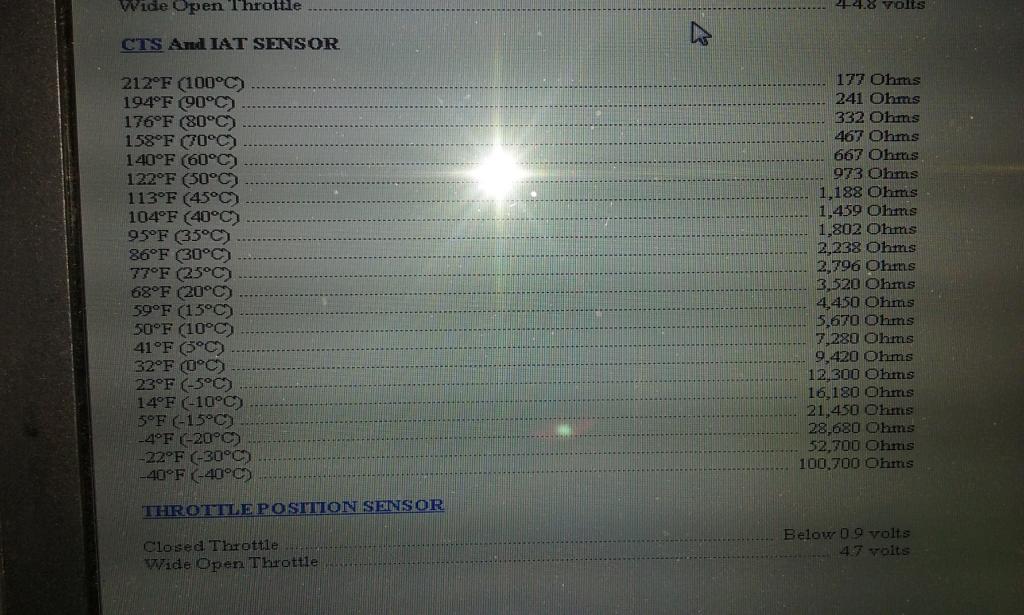

Imp558 Posted December 22, 2017 Report Posted December 22, 2017 Looks like the truth table for the IAT and CTS are the same. Either can cause horrible fuel economy. If you just unplug them and read across the pins on the sensors with an ohmmeter it's easy enough to spot a faulty one. If the CTS has 3 wires it will be the 2 pins that line up with the yellow and black wires. The green wire on a 3 wire sensor is for the gauge. Sorry for the crapoopy image. Quote
55trucker Posted December 22, 2017 Report Posted December 22, 2017 A '92 LQ1 engine has 2 coolant temp sensors. The ECM sensor is located on the bottomside end of the intake manifold under the throttle body, it is a two pin sensor. The sensor for the gauge is located in the back end of the forward cylinder head, it is totally obscured from sight by the engine lift support & the exhaust crossover, it is a single wire harness. Nice graph on the sensor resistance slope. I take it that those readings are for the ECM sensor, too bad the FSM doesn't include that in it's information Quote
