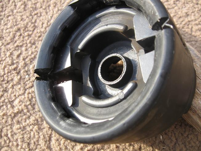

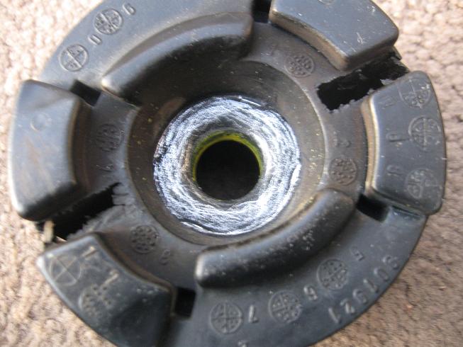

So I removed the large nut and the strut mount expecting to find damage to the threads on the top of the strut. I could not find any damage to the threads but when I looked at the underside of the strut mount I saw why the strut nut was loose.
The plate that the cartridge mounts to had crushed flashing around the flange that sits on top of the cartridge shaft shoulder. There was also some rubber from the molding that was on top that prevented the nut from seating against the steel.
Ground off the flashing on the bottom and scraped off the extra rubber on top on both front strut mounts. Put every thing back together and all of the scraping noise is Gone.

In the picture the bottom steel plate is removed showing the the upper steel plate that is molded into the rubber.
