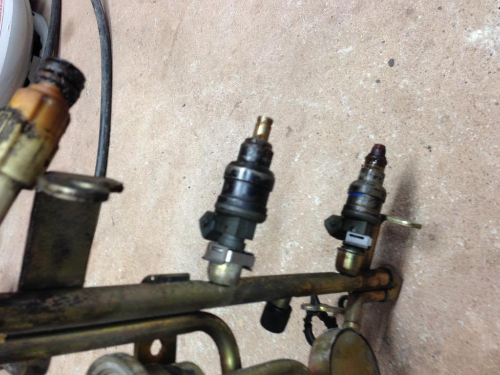

Billgluckman Posted November 26, 2017 Author Report Posted November 26, 2017 Do these injectors look familiar to anyone? Quote
Imp558 Posted November 26, 2017 Report Posted November 26, 2017 Do these injectors look familiar to anyone? Vortec truck engine? The white ones are the right ones. Quote

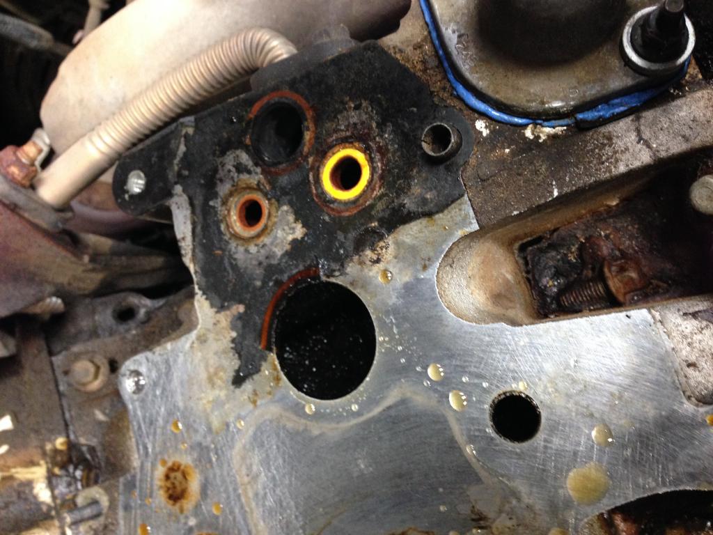

Billgluckman Posted November 26, 2017 Author Report Posted November 26, 2017 I may have found the issue, are those coolant ports that go through the supercharger? It looks like it to me, but I'm new to these. Thanks I'll check the link later, I'm still digging into this lol. Quote
Imp558 Posted November 26, 2017 Report Posted November 26, 2017 yes, for the throttle body heater. if those are leaking you may get coolant into a cylinder. I'd look closely at 5 and 6 spark plug to see if there's evidence of water on them. how do you like the l67? It's not terrible to get to anything. I honestly don't mind working on them even in the car but things get easier if you pull the strut Tower bar Quote
Imp558 Posted November 26, 2017 Report Posted November 26, 2017 in that picture, fresh silicone on the thermostat housing. I'll bet the water you saw on the intake manifold was from them putting a thermostat in it Quote
Billgluckman Posted November 26, 2017 Author Report Posted November 26, 2017 Possibly but it looks to me like it was coming from between s/c and intake. The intake gaskets are bad as well. I found more vacuum leaks and loose bolts too. I'm gonna try and get away with new gaskets and a tune up. As for working on the l67, it's not too bad but I'm used to rwd v8 which is easier in most cases. Quote
Billgluckman Posted November 26, 2017 Author Report Posted November 26, 2017 Oh and I found the 2 missing injectors in the car. I also pulled the plugs associated with those 2 cylinders and it looks like they were getting coolant so I'm hoping the 2 injectors that were removed were actually good. Quote
Imp558 Posted November 26, 2017 Report Posted November 26, 2017 You can test them. it's okay to power them up for a couple seconds at a time with a 9 volt battery and see if you can blow through them. it won't say a how well they're spraying that it will tell you that they're opening. stuck open is worse Quote
Billgluckman Posted November 27, 2017 Author Report Posted November 27, 2017 I'm willing to bet they're fine. Someone was taking a stab at the misfire most likely. Gaskets are ordered. If this doesn't get it I'm only about $50. Quote
