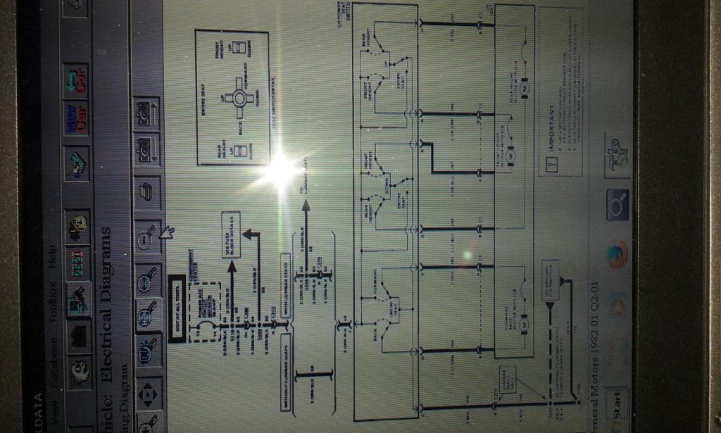

55trucker Posted November 2, 2017 Report Posted November 2, 2017 Yes. Thanks It's not a fuse, it's a 30 amp circuit breaker The power seat system has three motors, I take it that all three are not functioning? Disconnect the harness from under the seat & use a probe to see if you still have power to the input (that should be orange/black). Quote
Imp558 Posted November 3, 2017 Report Posted November 3, 2017 (edited) C313 is under the driver's seat. G304 is right next to it, check both for corrosion. Could also check pin F at the switch for power. Edited November 3, 2017 by Imp558 Quote
