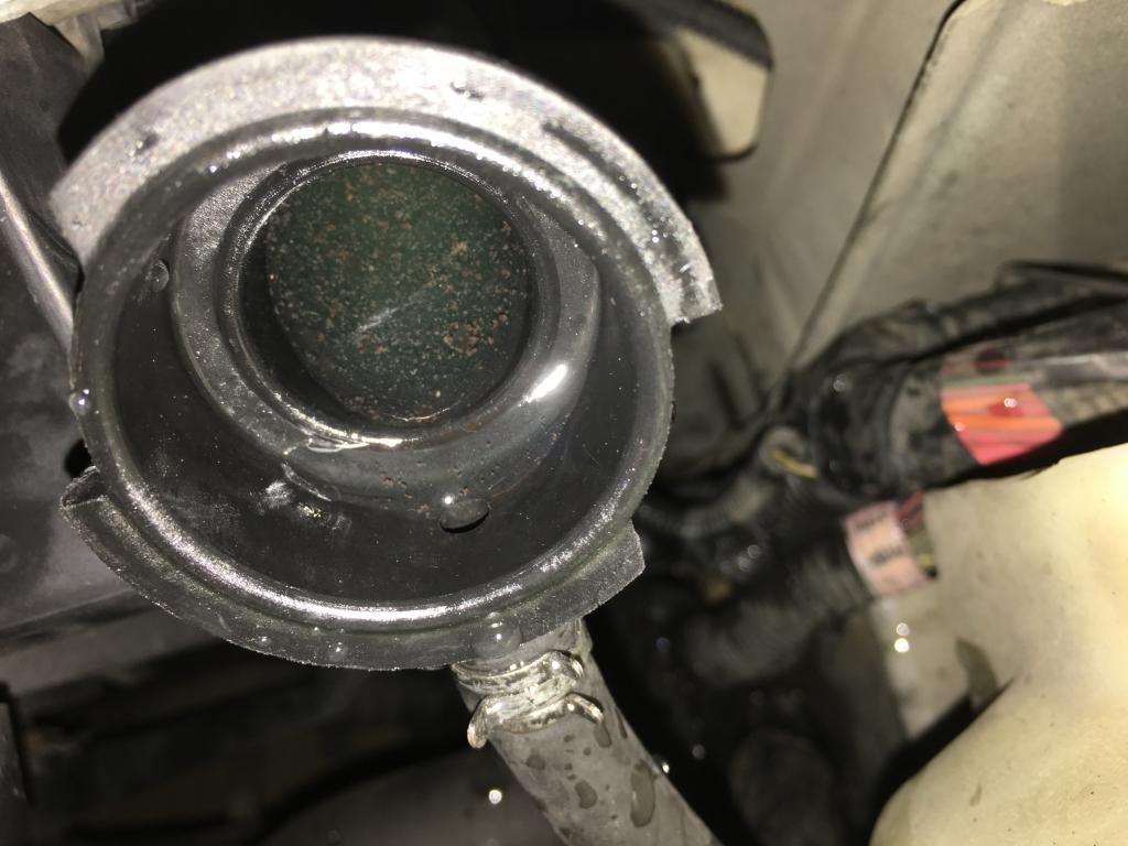

NCTyphoonKid Posted September 30, 2017 Report Posted September 30, 2017 Just as the title says what is the proper/best way to flush the system out. I swapped out radiators guess it had a leak in the internal cooler. Want to make sure everything is good, I did flush with water and some dish soap but still have remnants showing up. Quote

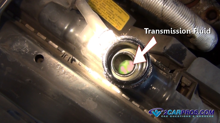

NCTyphoonKid Posted October 1, 2017 Author Report Posted October 1, 2017 I'm pretty sure it's not oil the picture is deceiving. This is similar to what I saw earlier. I should've swapped the radiator from my parts car when I did the swap but I swapped it in today. I was wanting to flush it the best I can to make sure everything will be ok now. Quote
Schurkey Posted October 1, 2017 Report Posted October 1, 2017 Keep flushing. Don't add anti-freeze until you're sure it's clean--unless you're in an area of freezing temperature. "I" would fill with water and a hint of detergent, drive it for an hour, dump the water. Refill, another hint of detergent, drive it an hour. Dump. Refill. Repeat as needed. When there's no trace of ATF when you check under the rad cap, flush without the detergent, and then you're ready for the anti-freeze. You'll be well-versed in the bleeding procedure after all this. Nas Escobar 1 Quote
NCTyphoonKid Posted October 1, 2017 Author Report Posted October 1, 2017 Keep flushing. Don't add anti-freeze until you're sure it's clean--unless you're in an area of freezing temperature. "I" would fill with water and a hint of detergent, drive it for an hour, dump the water. Refill, another hint of detergent, drive it an hour. Dump. Refill. Repeat as needed. When there's no trace of ATF when you check under the rad cap, flush without the detergent, and then you're ready for the anti-freeze. You'll be well-versed in the bleeding procedure after all this. I'll give that a shot tomorrow then. It's definitely not as bad as it was I put the water hose in the radiator and turned the heat on and let the car idle for a little while letting the water run through it with the drain open. Quote
