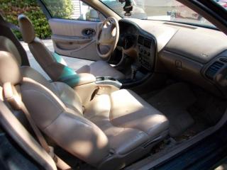

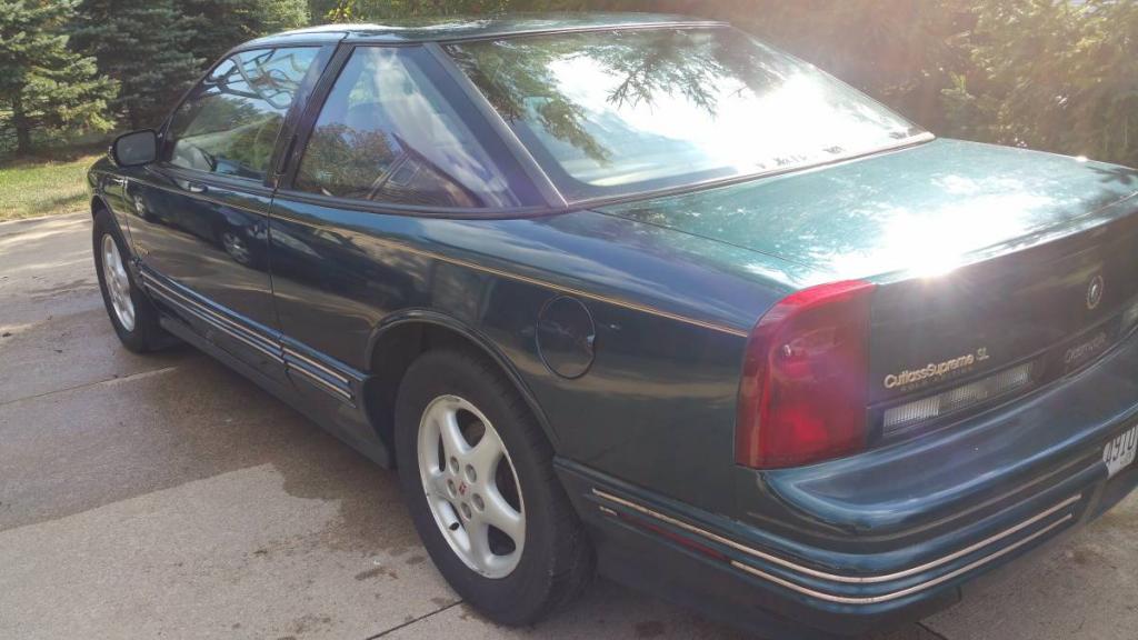

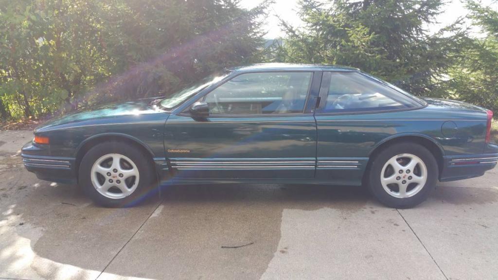

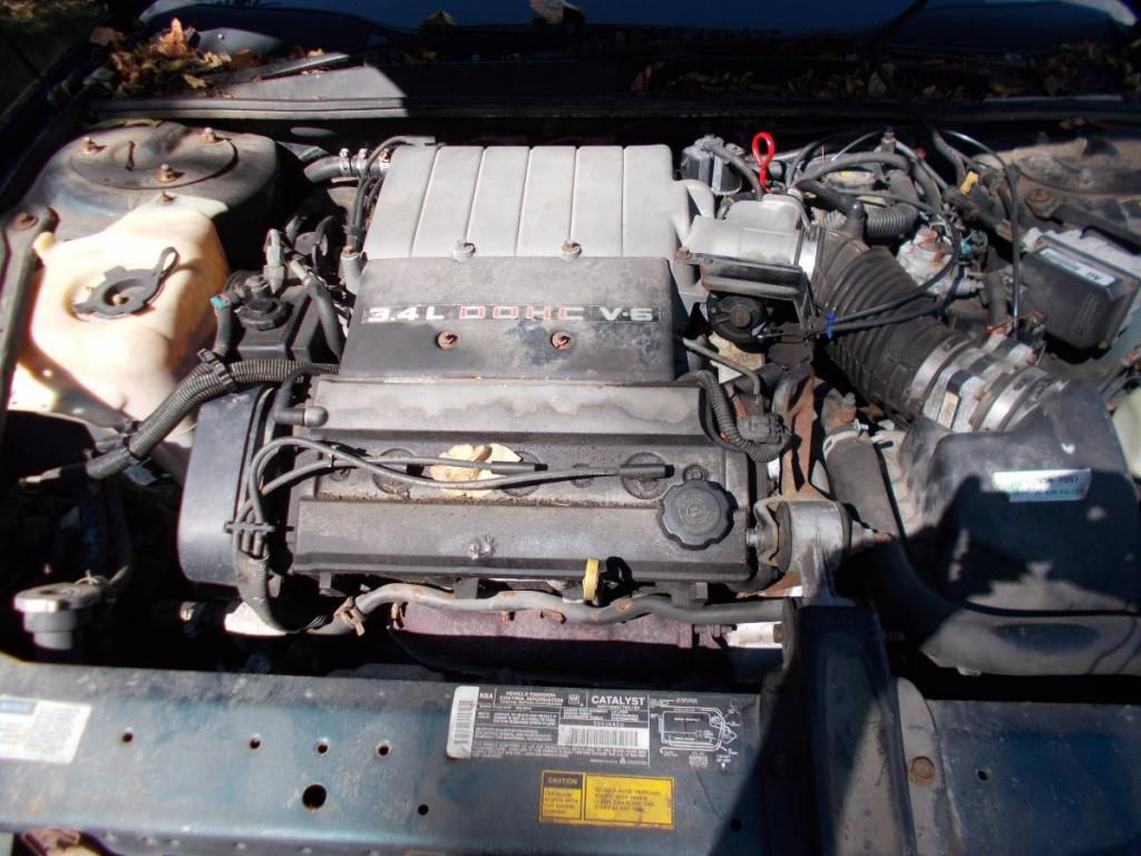

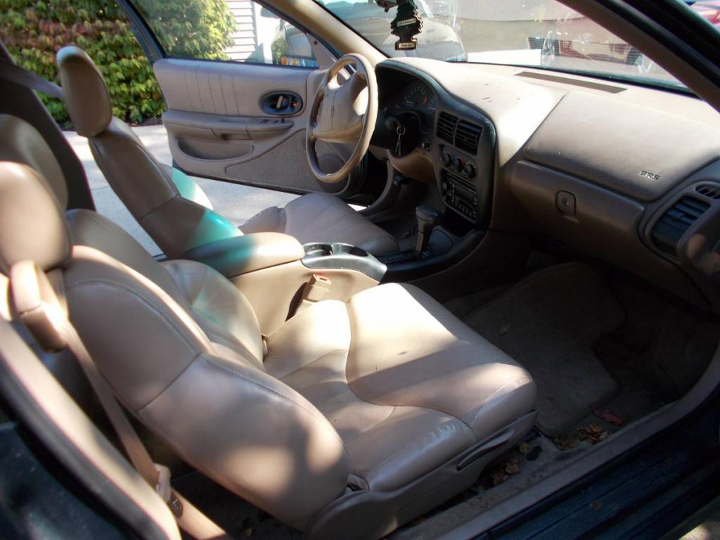

MemphisMan Posted September 29, 2017 Report Posted September 29, 2017 (edited) Hey all. I'm seriously looking for a fraternal twin (aka coupe) version of my vert. I found this 95 coupe on cl and it's got me a little confused. It's got an LQ1, but doesn't have ECC to include steering wheel controls. I learn something new every day because I was thought all LQ1 equipped cars came with ECC and steering wheel controls. That being said, would this car be pre-wired for ECC or should I keep looking? I just don't see may 95 green/tan/LQ1 coupes in decent shape for sale anymore. https://akroncanton.craigslist.org/cto/d/1995-oldsmobile-cutlass/6316641377.html Edited September 29, 2017 by MemphisMan rich_e777 1 Quote
