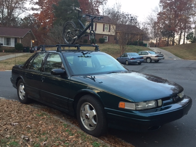

I found all parts needed for the roof rack.  Although Yakima has not made any of the parts except for the round bars for the past 20 years, I was able to find all parts needed through rerack.com and ebay.  Part numbers are given below:
1C SST towers (4 required)
Y27 clips (2 pair required)
48" round bars (2 required)
This roof rack system is limited to 165 lbs.  I doubt many folks wish to put roof racks on these cars, but here's the info should you need it.  This setup works with both the 2-door and 4-door Cutlass Supreme, Regal, and Grand Prix.  It will work on the first generation Lumina as well, but it requires different clips.  Yakima currently offers a new rack for that car anyway.  I am still waiting on the rack to arrive.  I'll post back to confirm the fit.

Took me a while to find the Y-27 clips.  I need to correct my previous post here.  The Y-27 clips are exclusive to the 4-door models of the Cutlass Supreme, Grand Prix, and Regal.  Y-20 clips are required for the 2-door versions.  Here's a photo of the rack installed.
