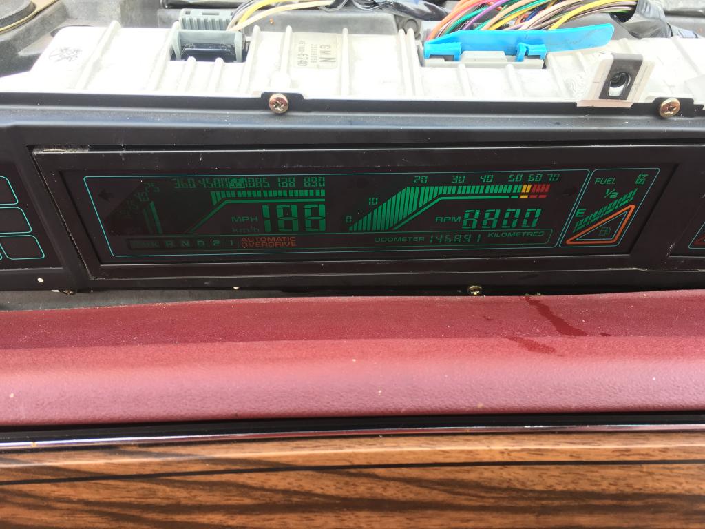

roadhawk Posted September 17, 2017 Report Posted September 17, 2017 where do i start search ,or is it the cluster panel , Quote
94 olds vert Posted September 17, 2017 Report Posted September 17, 2017 The first thing I would look at would be the solder joints on the back of the board. Look for cracks. If they are cracked they need to be soldered. Quote
89-W-Body-Regal Posted May 6, 2018 Report Posted May 6, 2018 How do you fix that? Rebuild the cluster? Quote
GTP091 Posted May 14, 2018 Report Posted May 14, 2018 Expose the board and get your soldering iron out. You just need to melt the solder and let it solidify, keep in mind it might have lead in it so use a respirator or hold your breath at least. You likely wont be able to see any breaks in the solder so don't get discouraged if it looks fine. Might need to use acetone to remove the protective coating from the solder though. The PCB will be coated for sure but I can remember if the solder joints were sprayed as well. You can tell easily if the solder feels 'sticky' when you scratch it with your finger nail. I cleaned my board with acetone and got lots of little 'rubbery boogers' off of it. it helps to put the acetone in a very small spray bottle and have a small brush to get in there right after. I did this repair many years ago to fix some bulbs that would only light up when it got warm. Quote
