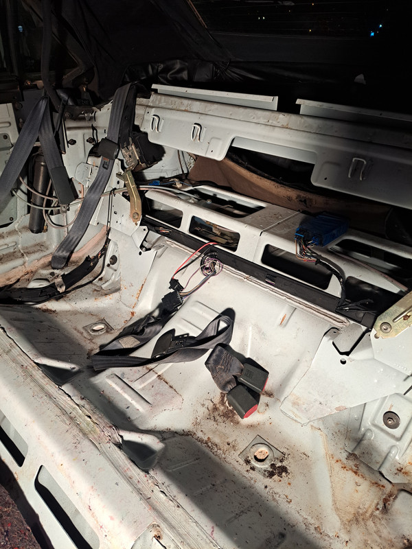

I`ll have them out tomorrow and will get some measurements and pics. So far the difference I see is where the carpet ends at. On the coupe the carpet goes all the way beneath the rear seat and into the trunk, on the convertible the carpet is trimmed to end under the rear seat and a black insulation pad carries on up the welded bracing for the convertible top.

Ok lets start with the backseat area, thats as far as I am with yard work pressing. More to come tomorrow and will get into the `94 coupe for comparison.
Here is what it looks like underneath. This is a `95 and other than a cosmetic difference in the trim, it should be about the same for all convertible Cutlass Supremes. I have not cleaned it up yet nor looked closer at the rust spots but nothing jumped out as alarming just yet. You can see where the carpet is just trimmed to fit around the rear seat belt bolts. Use the bolts to make a line as to where to end the carpet at, the rear insulation pad overlaps the carpet by a few inches.
  • Like 1
There seems to be a brace added that might affect the way the coupe carpet lays across the rear seat hump. The bolt provision for the rear seat is just above my hand for reference. There may be some other additions like this in the front. Will update again tomorrow.
I dont think the coupes have this reinforcement piece here.

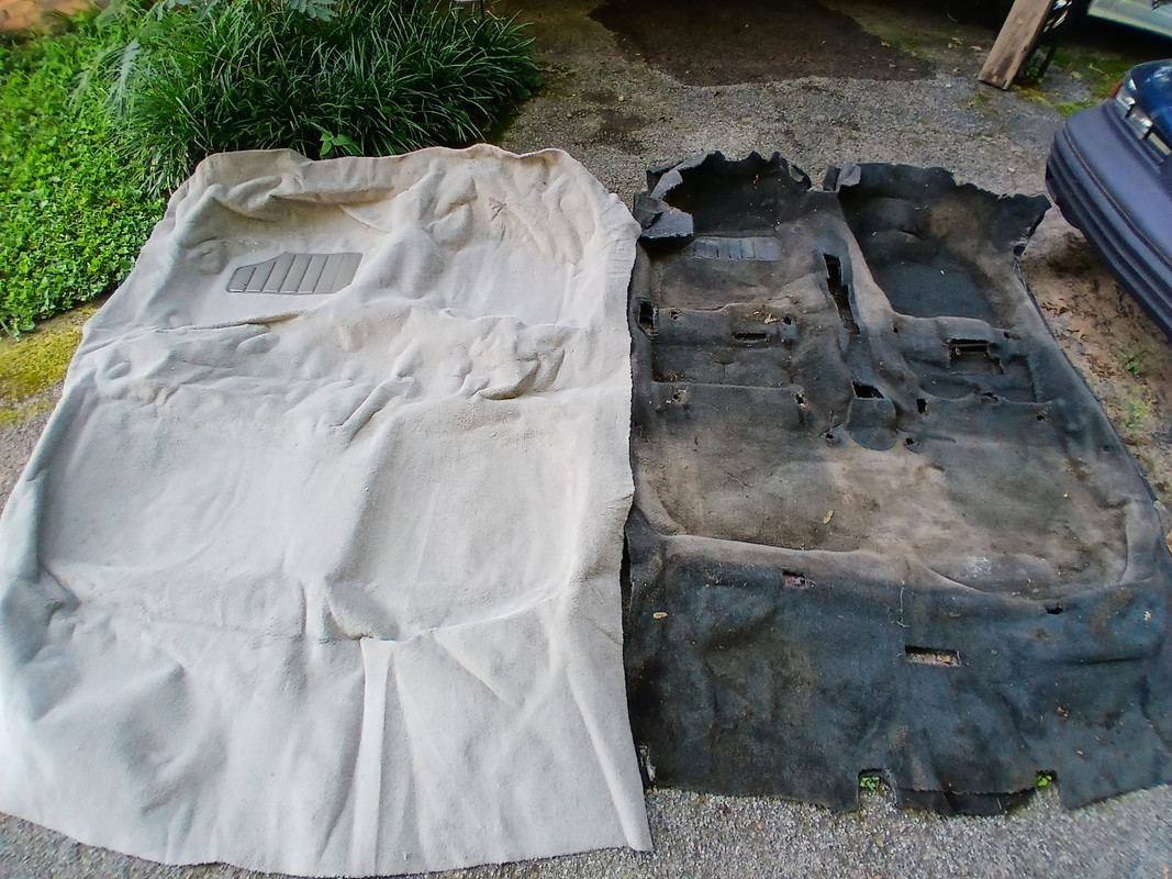

I`ll get back to it in the next few days with some more pics for the front. Ive read where there could be some reinforcement on the inside rocker panel area. If its a similar bulge then that might make the coupe carpet not wide enough to fit over it. I`m also going to try and swap carpets between the two models once there both out.

Ive not seen any differences in the carpets other than the rear area I posted earlier about. Ive got the convertible carpet removed completely and have been deep cleaning. I dont see any structural differences in the floor pan layout between the coupe and convertible until you get to just behind the rear seats.
Life events are holding me up ordering the carpets right now. But when I do I personally will be ordering two identical slate grey carpets from RockAuto for a 1994 Cutlass Supreme and trimming one to fit my 1995 convertible.
