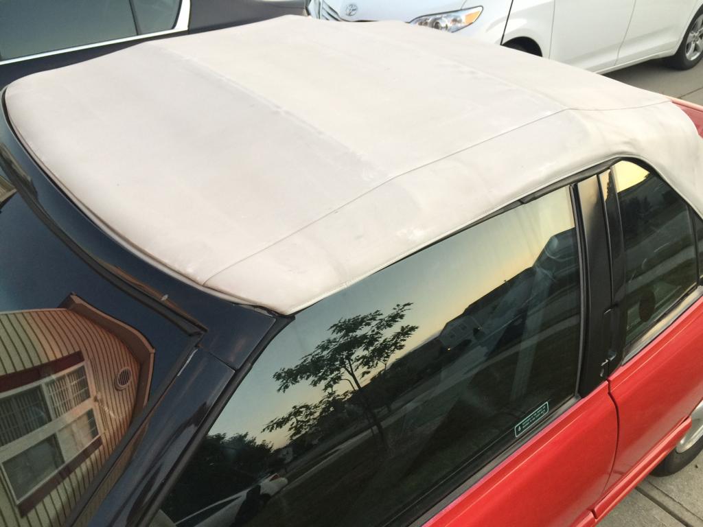

Lucky for me maybe not. We are possibly moving and well, the car gets to sit outside instead of in the garage. Just curious to know how to get the white convertible top cleaner than it is.
Thanks for the help!
There are vinyl and convertible top cleaners on the market. Meguiars makes one or two. it's typically a soft bristle brush and cleaner
Amazing Roll Off
Clear coat safe/good for convert top
Spray on - rinse off (may want to agitate with brush)
RaggTopp Vinyl Protectant
Endorsed by Haartz
UV Protector
Spray on, wipe off
That is my process ^^ here is a video too, love this guy - he talks about cloth top, but touches on vinyl, plus some interesting ideas along the way: https://youtu.be/vmrKCKXx9FM
For hard stains, I used westley's blech-white and a Mr. clean magic eraser.
