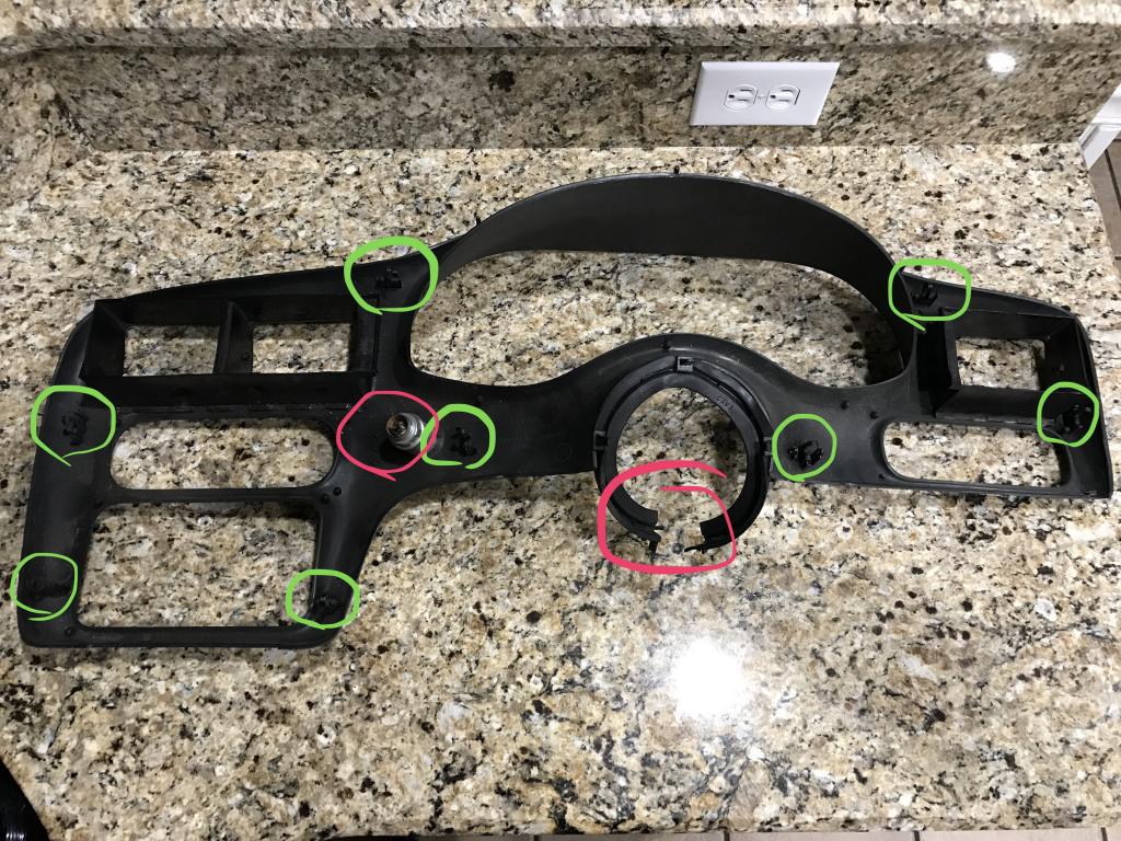

MemphisMan Posted August 16, 2017 Report Posted August 16, 2017 Be careful with the headlight switch knob too. When you're working off the part of the cluster surround (because it's so deep), it rubs on the knob. One way to avoid this altogether is to unbolt the steering column, which lowers the steering wheel down until it rests on the seat bottom. It's an extra step, but all it involves is removing the plastic knee panel, which is 4 8mm screws, then unbolting the 2 or 4 bolts that hold up the steering wheel. It takes less than 5 minutes to do it then the dash bezel comes out much more easier. I had my dash bezel hydrodipped so I take the extra precaution not to scratch it. If you want I can take a picture of the back of an extra dash bezel I have so you can see exactly where the spring clips are located. Galaxie500XL 1 Quote

bluecalais79 Posted August 16, 2017 Author Report Posted August 16, 2017 That would be great if you could take a photo of the back of the dash bezel, that would be a huge help, thanks, I'd like to see just where I need to carefully work this out of the dash. I did see the e bay site you mentioned above, but I passed on it in favor of getting a new unit per Galaxie500XL's lead. I've got no current need for an aux port, it was tempting but between the radio, cassettes, CD's I've got a lot of sound options as the ready. Thanks again, much appreciated!. Quote
MemphisMan Posted August 16, 2017 Report Posted August 16, 2017 That would be great if you could take a photo of the back of the dash bezel, that would be a huge help, thanks, I'd like to see just where I need to carefully work this out of the dash. I did see the e bay site you mentioned above, but I passed on it in favor of getting a new unit per Galaxie500XL's lead. I've got no current need for an aux port, it was tempting but between the radio, cassettes, CD's I've got a lot of sound options as the ready. Thanks again, much appreciated!.No problem. I'll get a pic of it and post it tonight. Quote
MemphisMan Posted August 17, 2017 Report Posted August 17, 2017 Green indicates spring clips and just pull straight out. Red indicates the cigarette lighter wire and the rubber grommet. Both need to be disconnected to remove the bezel. Quote

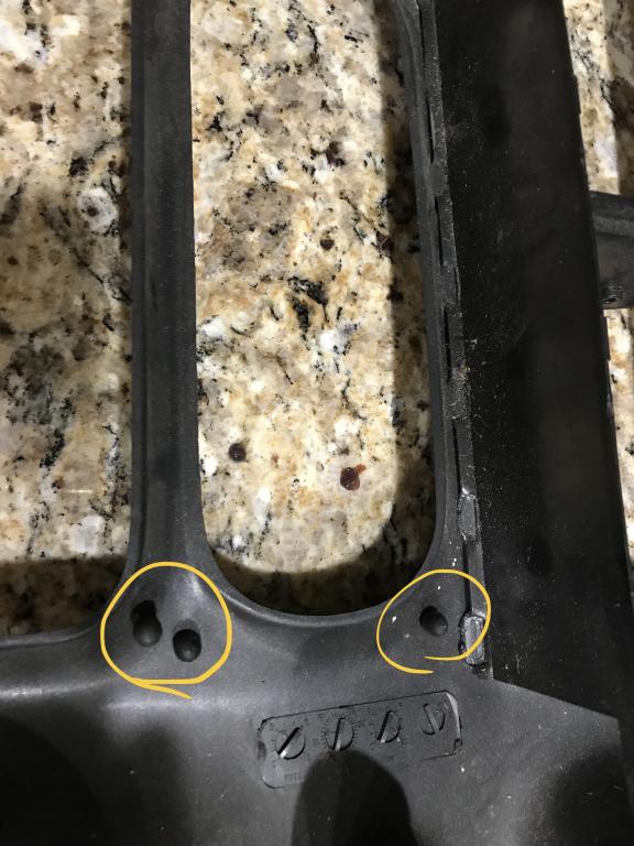

MemphisMan Posted August 17, 2017 Report Posted August 17, 2017 Also, you'll see these little rubber pads all over the back of the bezel. They always want to fall off. 16 of them it looks like. I've lost a couple over time and miraculously my car still runs lol. Quote
