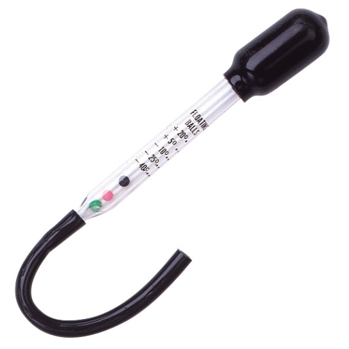

Imp558 Posted July 17, 2017 Report Posted July 17, 2017 I'm not sure where you live and whether or not it's important to have coolant that doesn't freeze but there's more to coolant than that. For one it's all pretty much the same but as Nas said a "Better" brand may have a higher concentration of Ethylene Glycol. The cooling system is made to run with alcohol in it so it boils at a higher temperature. Pressurized systems will also help keep from boiling. Water is a bad idea. On a personal note I don't run Dex-Cool, or expensive coolant for that matter. I do have a little tool that I test the cars with before winter. 95GS 1 Quote
