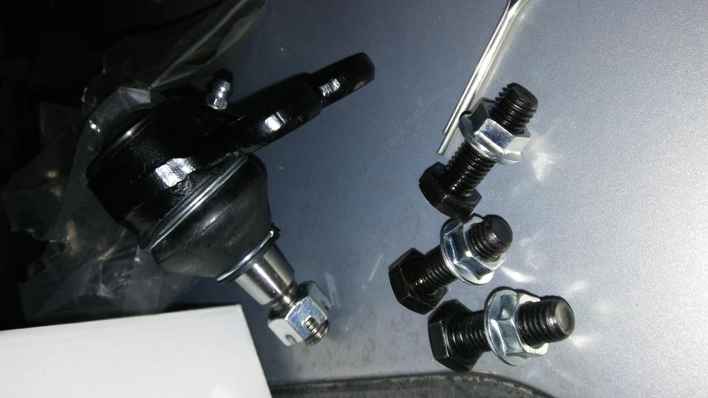

98gpgt Posted July 11, 2017 Report Posted July 11, 2017 This set actually came with uninstalled grease fittings. I ordered 2 sets accidentally, and a good thing I did, as the one set didn't come with them and I would have assumed they were good to go. So am I actually supposed to drill into the shiney metal? What about a suitable sized nail or punch. All those ftagments from drilling give me the willies. And both sets are the "sealed" type, a round metal clip or skinny band keeps the boot well sealed. Quote
digitaloutsider Posted July 11, 2017 Report Posted July 11, 2017 Using the cheapest possible garbage on a critical suspension component like a ball joint personally gives me the willies. So even the ball joints that came with the grease fittings in the box didn't come drilled? Most cheap suspension components are non-greasable. Are you sure they didn't throw the grease zerks in there by accident? Imp558 1 Quote
Schurkey Posted July 11, 2017 Report Posted July 11, 2017 If you don't have holes to screw the zerks into, they don't belong on that joint. White93z34 1 Quote
98gpgt Posted July 11, 2017 Author Report Posted July 11, 2017 If you look on rock you'll see some are specifically specified as not coming with greese fiitings. One of those sets I ordered. And have yet to look at them side by side, but both are more or less identical I think. I don't want to assume there's enough greese already in there. I don't know. Wasn't going to dump buku dollars into a car I paid 300$ for. If it lasts and cheapo parts give out, by better ones. I'm not made of cash right now. Quote
98gpgt Posted July 13, 2017 Author Report Posted July 13, 2017 Okay like I said I got two sets. The better of the 2 came with grease fittings and happily holes to screw them into. It's my lucky day. But even with that issue resolved, there'as the issue of the supplied 3 bolts and nuts which don't have the luxury of cotter pins as the bolt opposite the ball does. I obtained a set for my old Lumina which had pressed in nylon bushings or whatever they were to keep the nuts from falling off due to vibration. Do I just snug these up and hope fornthe best? Quote
Imp558 Posted July 14, 2017 Report Posted July 14, 2017 Those look like whizz nuts, so they are a locknut. Just to be safe it wouldn't be a bad idea to torque them to spec and then use your favorite center punch or chisel to ding the first thread on top of the nut. I like the center punch better but that's me. Quote
98gpgt Posted July 14, 2017 Author Report Posted July 14, 2017 Ok that I'll do. Being on the last balljoint I installed (my uber low maintenance 92 Lumina fantasy car), I dropped the bolts down, so even if the nuts came loose, well there would be something holding the assembly on, for a bit anyway. So I take it I'll be dinging under the nut. But anyway I looked at the enclosed invoice and saw that these things were under 16$ with the shipping. Everything is made in China these days. Am I actually risking life and limb by installing these??? They look pretty good to me, but as we all know looks aren't everything. Quote
