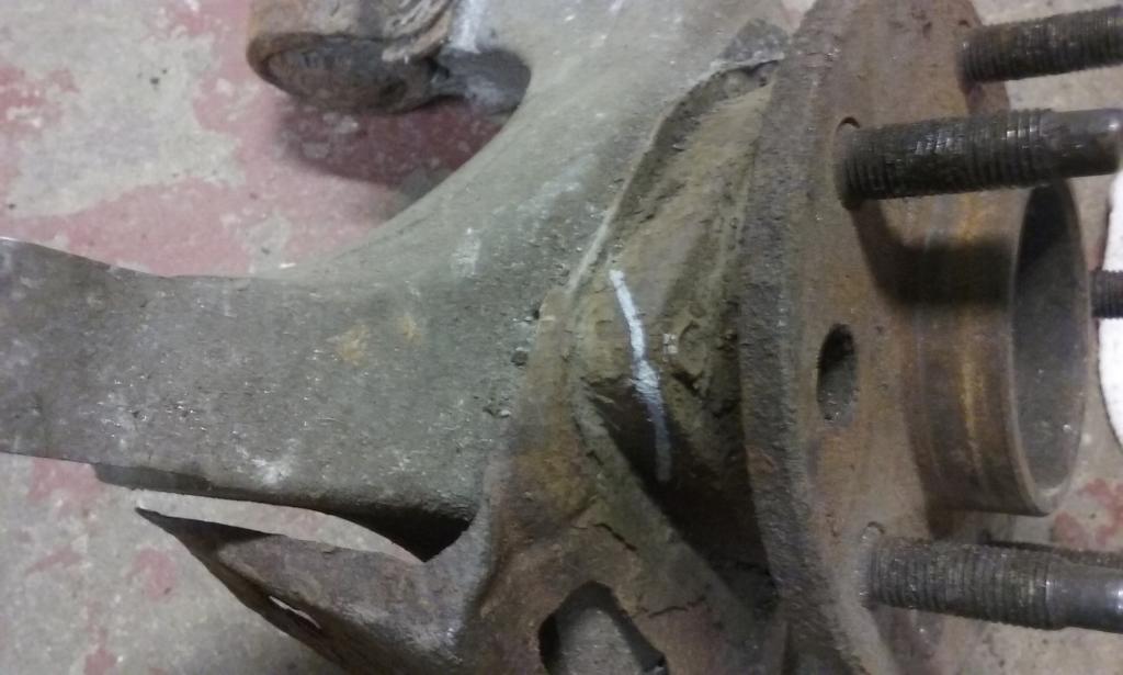

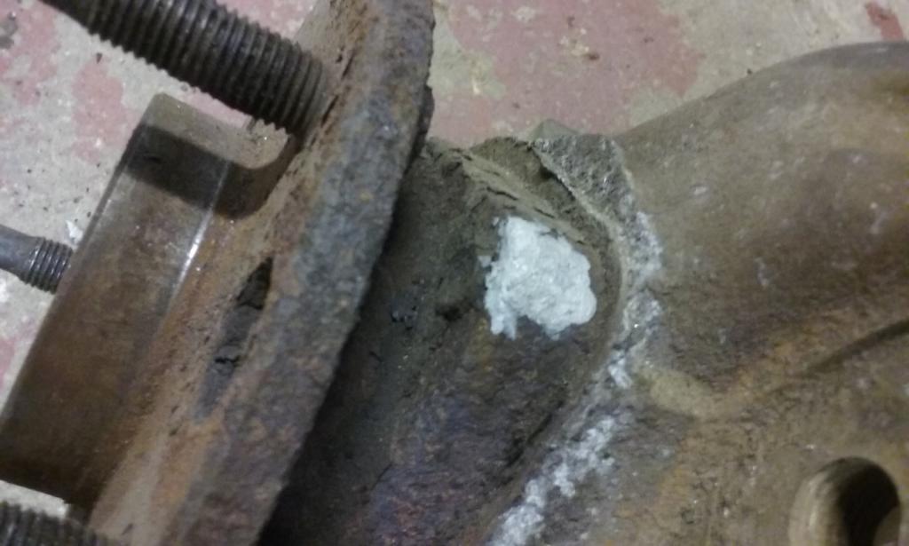

Imp558 Posted July 6, 2017 Report Posted July 6, 2017 I'm an idiot, there was a second gen assembly 15 feet away from me. This is about the same as a first gen or an H- Body. I'd either make an incision with an angle grinder about like the first picture and then spread it open the rest of the way with a chisel leaving only half of a bolt in there to deal with like I marked the first picture here. or I would use a grinder wheel on the angle grinder to remove an area like what I have marked in this section on the second picture. I've done it both ways with success. Theoretically you could drill through one of those holes in the hub portion of the assembly and drill down the middle of the bolts but they're crazy hard man. just be careful not to nick the spindle too bad or you will have to replace it for safety. Quote
98gpgt Posted July 6, 2017 Author Report Posted July 6, 2017 I had thought you meant making a slit perpendicular to the line in the first picture ... Quote
Imp558 Posted July 6, 2017 Report Posted July 6, 2017 I've done that too, but it only works with a dremel. If you have an angle grinder it's fastest to do the first pic, and safest to do the second Quote
