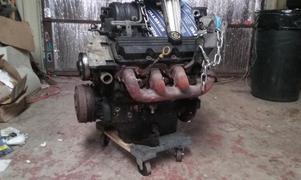

Imp558 Posted July 3, 2017 Author Report Posted July 3, 2017 Harbor freight furniture dolley, cheap and has no problem holding engines so I can move them around easily without tying up one of my engine stands. This LOOKS scary but this guy absolutely doesn't care about being loaded with this entire L36, there's another one here holding a shortblock and they roll effortlessly for the most part. cheatah faheatah, 95GS, Grandprix1 and 1 other 4 Quote

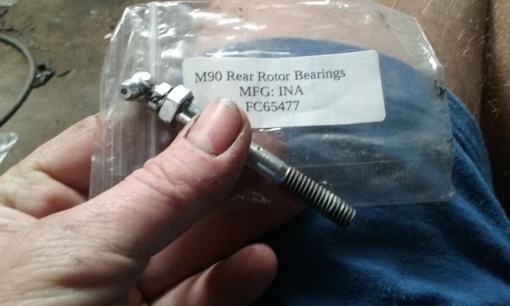

Imp558 Posted July 3, 2017 Author Report Posted July 3, 2017 M90 Gen III Rear rotor bearing removal tool! I can't take credit for this one because I got it from a YouTube vid. Anyway, a Gen III has 2 holes from underneath that enter into the passages behind the bearings and they tap out easily to 5/16-18. This little guy here is a 5/16-18×2 1/2" bolt drilled all the way through with an 1/8" bit on my drillpress. Then I opened the top of the hole a tad and threaded it 1/4-28 to accept thee grease fitting. A little Teflon tape on the bolt before threading it into the blower housing and your grease gun will provide enough pressure to pop those blind bitches right out. Replacement bearings were not available at my local supplier but were only $20/set on Ebay for oe brand. The oe ones are: INA , P/N: FC65477 carkhz316 and Psych0matt 2 Quote

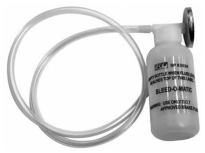

Imp558 Posted July 13, 2017 Author Report Posted July 13, 2017 I used one of these cheesy little one-man brake bleeders last night for the first time. All I can say is WOW, I'll never do it without a little contraption like this again. 94 olds vert and digitaloutsider 2 Quote
Nas Escobar Posted July 14, 2017 Report Posted July 14, 2017 I've used those before. They suck. You're better off using a clean empty Gatorade bottle zip tied to the strut with the clear hose than that small fuckery. Then again my brake lines almost always have a lot of air. Quote
digitaloutsider Posted July 14, 2017 Report Posted July 14, 2017 Really? I've had good luck with the little one-man bleeders. I wonder where mine ran off to. Quote
Imp558 Posted July 16, 2017 Author Report Posted July 16, 2017 I bled the new rear brake lines solo in about 10 minutes with that. Much more fun than wedging a snow brush between the seat and brake pedal while I crack the bleeder. digitaloutsider 1 Quote

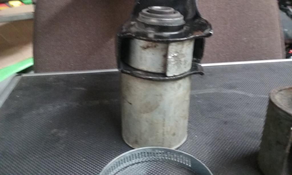

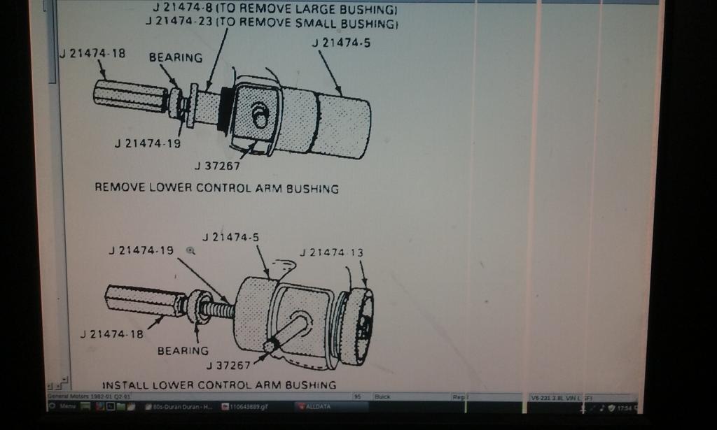

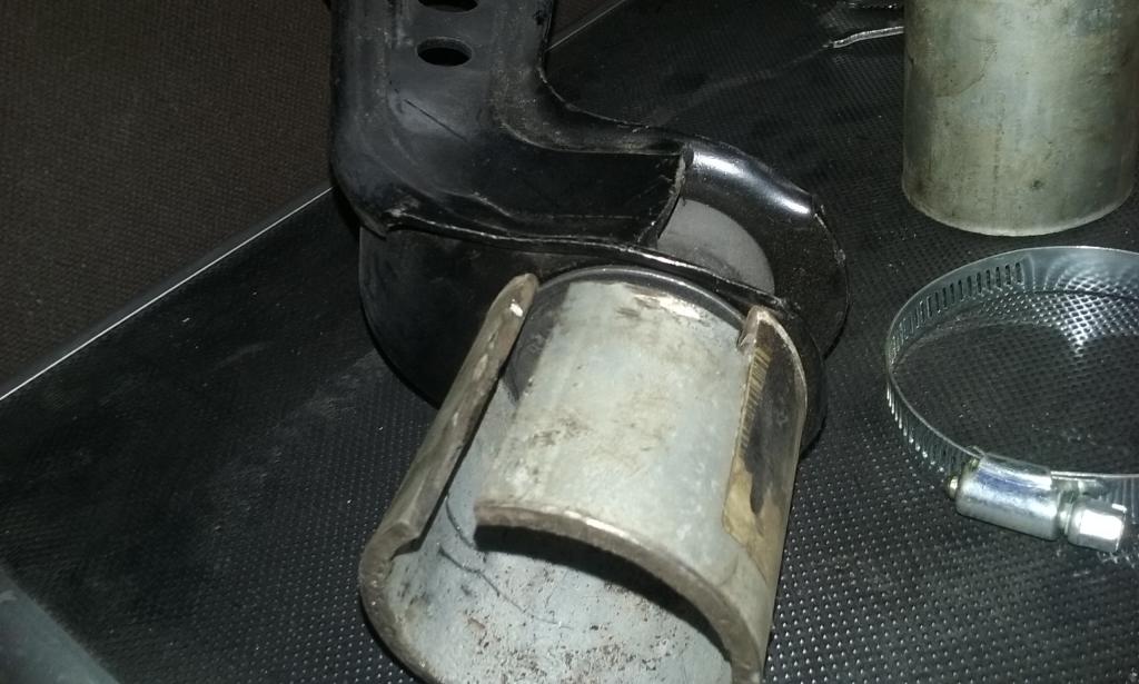

Imp558 Posted January 9, 2018 Author Report Posted January 9, 2018 Stuck at work waiting for Renee to pick me up. We are down to one car right now for the next couple days. anyway it dawned on me that I can start working on my control arms anytime now since I've already got the poly bushings in. Then that got me thinking of the little Doodle I fabricated to press bushings in and out of first gen control arms without just crushing them. There were special tools to keep the a arm from collapsing but I'm not fortunate enough to own one of those sets so I had to go to the hardware store and get a hunk of 2-inch pipe. I use a large socket, and the two hunks of pipe in my vise. The two pieces that resemble main bearings were cut out of the same 2" pipe, they are just a little snug when put in the A-arm. In practice I put the hose clamp on so they don't cock or move. It was necessary to notch one of my hunks of pipe to clear the rib on the edge on one side. 94 olds vert 1 Quote
ron350 Posted January 10, 2018 Report Posted January 10, 2018 Imp558 I like those bushing tools. What is the width of those two half pieces? Quote
Imp558 Posted January 10, 2018 Author Report Posted January 10, 2018 I measured the arm and cut the pipe with a pipe cutter but then there was a lot of dressing with a grinder to get them just right. It would be best to do the same or you could end up with one that is too sloppy. Quote

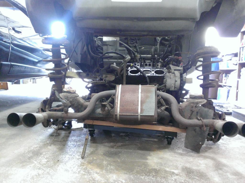

no1kicker Posted January 14, 2018 Report Posted January 14, 2018 I have had good luck with the furniture floor dollys from harbor freight. I am using the blue plastic ones. I used one to help remove the cradle assy from a Fiero with the engine and trans on it. I am now using it to hold a cradle with a 3800 and 4t65e. It seems to be fine with the weight. It is rated to hold 1000 lbs. A few years back I had an entire 2005 GTP subframe assy shipped to me with everything but the suspension and the shipping rate was about 900 lbs. When I had my 1990 GP I used an engine tilter to help with plug changes. It worked well and IIRC it was a rental tool at the time. Imp558 1 Quote
