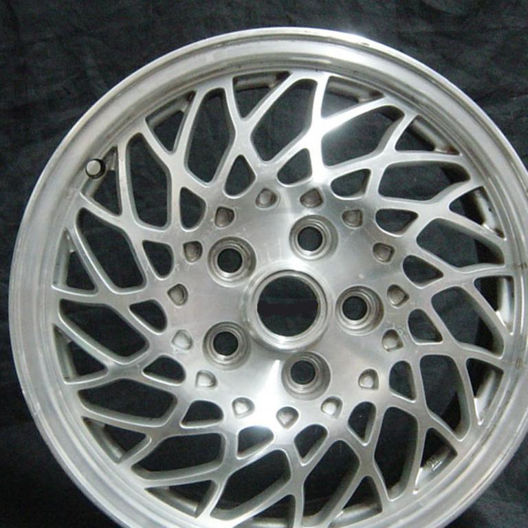

Would the wheels from a 2000 Grand Prix #6527 fit a 2002 Intrigue? Size appears to be the same 16 x 6.5 as well as bolt pattern 5 x 115mm. I do not know about the offsets though or the center hub size (see yellow line).
Yes they do. 75% of GM FWD wheels interchange with each other. The sole exception is  2G W wheels (97-05) can't go on a 1G W (88-96/97 for the Cutlass Supreme, 95-01 for the Lumina) without spacers. The reverse however, works fine (1G wheel on a 2G). 1G W's have a weird offset that's closer to an RWD one than a FWD one to accommodate the front brake caliper. Everything else usually works. You could put Cadillac wheels if you wanted to on your Intrigue and it works fine. I actually have an RWD STS spare that I use on my 94 Cutlass since I have 19" wheels on it. The spare is 17" but is the same height as my 19"s. The only catch is that I can't put it on the front because the Sigma cars use the same offset as the FWD cars, so it won't clear the caliper bracket on the front.
A number of fomoco vehicles had a 114.7 spacing that was close enough for rock and roll too.
Thanks to all for your help! It is much appreciated!

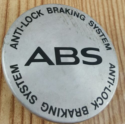

Now that I know the wheels will work I need to find the proper center caps. This is a bit difficult to sort out as there are so many similar looking caps but they are slightly different sizes apparently. From what I found it looks like the GM #PA6 might possibly be the proper cap for this wheel 1997-2000. Anyone know anything about what caps fit and which do not?
Should fit. Pretty much all the small center w body center caps interchange. In fact I had a center cap from a 92 lumina on an 07 gp gt 17" spare wheel I had
