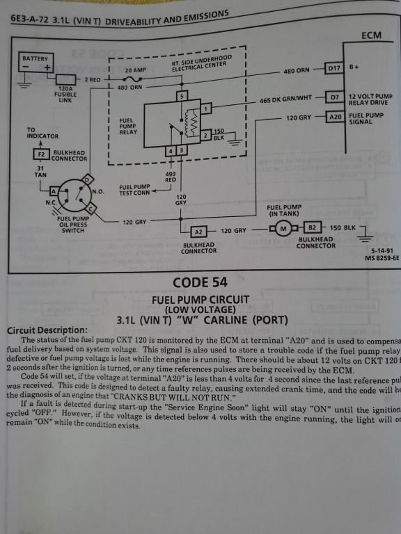

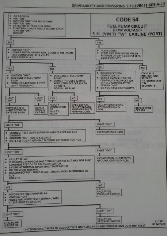

I'm working my way through the FSM diagnostics, but I'm getting a little confused by it as to where these actual circuits are.  If this is a well-known problem I haven't been able to find it by searching the archives yet, so if anyone else has already been through this and can offer suggestions that would be helpful.
I also just moved to a house on the sea in March, and increased corrosion is a potential issue from the increased salt levels in the air.  I've had issues with that UEC before with corroded fuses due to the high humidity, so I just replace them if they look like they're starting to have problems. Both that 10A FUEL/ECM fuse and the FP relay did - but it didn't help this time.  Being an intermittent problem, it certainly seems like corrosion somewhere might be a factor, but I'm not sure where else to look.  I'm also thinking it's time to use some electrolytic grease on all those exposed UEC terminals.
Anyway, here are the troubleshooting diagrams from the FSM that I've been trying to figure out.
