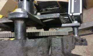

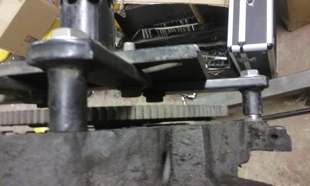

Imp558 Posted May 15, 2017 Author Report Posted May 15, 2017 Yeah, the L67 flywheel is balanced to an L67. I wasn't sure the 4T65 had the same input shaft spline as an HD. I'm going to buy a whole HD fw $200 from a running car this week so that'll give me a converter. This would be a fun place to post a pic of my "3800 Only!" modified engine stand, lol. Quote
