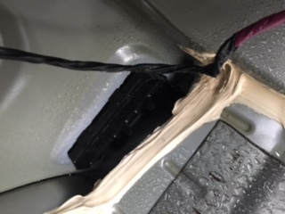

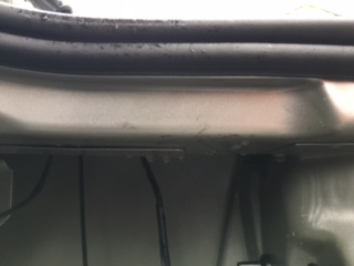

I'm trying to track down a bad leak in the trunk on the passenger side.  Water seems to mostly collect in the recess behind the passenger rear tire and some runs to the spare tire well.  I can see exactly where it's dripping from but don't know how the water is getting there.
I've ruled out the following:
1. tail light stud holes
2. weatherstripping
3. spoiler
4. I've siliconed the snot out of the trunk hinge bolt holes and body seams that I can access in the area
This all leads me to believe the leak may be near the bottom of the rear window and runs between the body panels until it can drip out near the seam back by the taillight but I can't see anything with the molding in place.  I'm assuming the water should just run down the rear window and into the "valley" where the hinge is and drain out by the taillight.

Yep. I can see exactly where it's dripping from but can't determine how the water is getting to that point.
