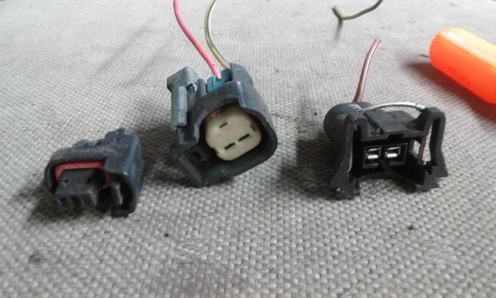

Grandprix1 Posted April 27, 2017 Author Report Share Posted April 27, 2017 Here is the injector connection. EV6 to EV1 correct? This being an EV1 what's on the car being an EV6? I'll take a pic of what's on the car tomorrow. Second image is an adapter that was on one of them. Also would connect to my injectors Sent from my iPhone using Tapatalk Quote Link to comment Share on other sites More sharing options...
Imp558 Posted April 27, 2017 Report Share Posted April 27, 2017 the injector plugs that are on your car should be Delphi mini, what you have there is not an adapter it's a plug that was torn apart Quote Link to comment Share on other sites More sharing options...
Imp558 Posted April 27, 2017 Report Share Posted April 27, 2017 left to right Delphi Mini, Delphi EV6, Delphi EV1... l67ss 1 Quote Link to comment Share on other sites More sharing options...
Grandprix1 Posted April 27, 2017 Author Report Share Posted April 27, 2017 left to right Delphi Mini, Delphi EV6, Delphi EV1... 20170427_160541.jpg yes that looks about right. So I need a Delphi mini to EV6? Sent from my iPhone using Tapatalk Quote Link to comment Share on other sites More sharing options...
Imp558 Posted April 27, 2017 Report Share Posted April 27, 2017 Mini to EV1, or the plugs I posted links to for $3 each and just crimp them on. Or you could use mini to EV6 adapters and plug that into EV6 to EV1 adapters to get the maximum combination of useless parts. Quote Link to comment Share on other sites More sharing options...
digitaloutsider Posted April 27, 2017 Report Share Posted April 27, 2017 Huh. I had no idea the 3800 ever used the Delphi mini/EV14. I always thought the 01+ L36s used EV6. Quote Link to comment Share on other sites More sharing options...
Imp558 Posted April 27, 2017 Report Share Posted April 27, 2017 He may have EV6 but this 01 Monte is mini so it would be odd. Quote Link to comment Share on other sites More sharing options...
digitaloutsider Posted April 27, 2017 Report Share Posted April 27, 2017 His factory plugs are definitely EV14. Looks like the L36 had them from 2001+. The L27 and L32 are all EV6. Learn something new every day. Quote Link to comment Share on other sites More sharing options...
Imp558 Posted April 28, 2017 Report Share Posted April 28, 2017 I've owned that Monte for almost 2 months and just noticed. digitaloutsider 1 Quote Link to comment Share on other sites More sharing options...
