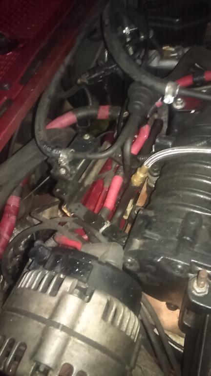

l67ss Posted April 27, 2017 Report Share Posted April 27, 2017 Where I have my map Quote Link to comment Share on other sites More sharing options...

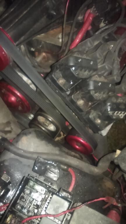

l67ss Posted April 27, 2017 Report Share Posted April 27, 2017 Best shot I could get of my pulley setup Quote Link to comment Share on other sites More sharing options...
Grandprix1 Posted April 27, 2017 Author Report Share Posted April 27, 2017 Nice thanks man! Looks like I've got someone who is not only giving me all the parts for $50 he's going to help install. I should have boost by the end of the summer if not sooner. This went way faster then expected. Thank the lord for W-body and Facebook Psych0matt 1 Quote Link to comment Share on other sites More sharing options...

Grandprix1 Posted April 27, 2017 Author Report Share Posted April 27, 2017 Does the map have a specific spot to put it in or do you just put it somewhere? And how do I make it so I can use my wire harness with that plug? Quote Link to comment Share on other sites More sharing options...

l67ss Posted April 27, 2017 Report Share Posted April 27, 2017 I'd splice in a plug yourself. I've heard less than positive results from zzp plug adapters. Actually rich Nero had issues with the injector plug adapters Quote Link to comment Share on other sites More sharing options...
