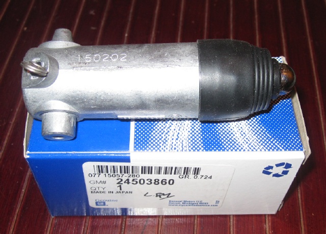

MemphisMan Posted April 14, 2017 Report Posted April 14, 2017 (edited) I successfully changed the timing belt, three pulleys, and actuator on my '95 Cutlass last weekend. It was my first time changing a timing belt on an LQ1. I followed the method outlined in the following video and it worked great! I'm not sure if anyone on this site has used this method, but I can verify that it works. Of note, this method only works if your engine is timed properly and with the old belt still in place (ie not broken). Total time using this method can be around an hour. It took me longer because I had a broken timing belt cover that I had to order and wait for it to arrive. I used the Gates TCK192 Timing Belt Component Kit ($118 from Amazon) and GM Actuator P/N: 24503860 ($76.53 + $8.56 shipping from group1autoparts.com). https://www.youtube.com/watch?v=d3fzI_ODZFI .Of note, I also replaced the serpentine belt. I can't believe how much easier it is to change the serpentine belt with the coolant reservoir removed! OMG!! Since it only takes a minute to remove the reservoir, I'll be removing it for all future serpentine belt changes. Edited April 14, 2017 by MemphisMan tonytoca_87 1 Quote

tonytoca_87 Posted April 26, 2017 Report Posted April 26, 2017 Thanks for sharing this info. I did not think of replacing the actuator. Do you think its important? I successfully changed the timing belt, three pulleys, and actuator on my '95 Cutlass last weekend. It was my first time changing a timing belt on an LQ1. I followed the method outlined in the following video and it worked great! I'm not sure if anyone on this site has used this method, but I can verify that it works. Of note, this method only works if your engine is timed properly and with the old belt still in place (ie not broken). Total time using this method can be around an hour. It took me longer because I had a broken timing belt cover that I had to order and wait for it to arrive. I used the Gates TCK192 Timing Belt Component Kit ($118 from Amazon) and GM Actuator P/N: 24503860 ($76.53 + $8.56 shipping from group1autoparts.com). https://www.youtube.com/watch?v=d3fzI_ODZFI .Of note, I also replaced the serpentine belt. I can't believe how much easier it is to change the serpentine belt with the coolant reservoir removed! OMG!! Since it only takes a minute to remove the reservoir, I'll be removing it for all future serpentine belt changes. Quote

dogginred90 Posted May 2, 2017 Report Posted May 2, 2017 If it was me, I would change the actuator every timing component change. Which they say every 60,000 miles. My son's LQ1 only has 90,000 miles on the odometer and I don't think the belt or anything was changed. So of course I did everything belt, pulleys(which fell apart), and the actuator(which the boot was torn and leaking). Better safe than sorry. Especially since this is my 16 year old son's car. Galaxie500XL 1 Quote
Galaxie500XL Posted May 3, 2017 Report Posted May 3, 2017 I guess I better watch video. How long actuators work for? It's really hard to say. I've heard of people never having replaced one, but on the other hand, I had one fail after only 35,000 miles, which meant I had to do everything all over again. Quote

MemphisMan Posted May 3, 2017 Author Report Posted May 3, 2017 If it was me, I would change the actuator every timing component change. Which they say every 60,000 miles. My son's LQ1 only has 90,000 miles on the odometer and I don't think the belt or anything was changed. So of course I did everything belt, pulleys(which fell apart), and the actuator(which the boot was torn and leaking). Better safe than sorry. Especially since this is my 16 year old son's car. I started inspecting my belt at 50k miles, then every 5k after that. i started noticing minor cracks at 60k, but not to the point I thought it needed changing. I'm talking extremely minor cracks. I waited until just north of 70k before doing the engines first timing belt change. I'm not saying to wait that long, but I monitored my belt like a hawk. It takes less than a minute to check the belt and I did it at each oil change. Quote

Galaxie500XL Posted May 3, 2017 Report Posted May 3, 2017 The thing is, sometimes you can't predict when there will be a problem. My first failure happened right after I started it up in the driveway. When the actuator failed, I was cruising at 40 MPH on a beautiful day---and suddenly the car quit. Quote

GOT2B GM Posted May 4, 2017 Report Posted May 4, 2017 Actuator, you are talking about tensioner? Yep Quote
White93z34 Posted May 4, 2017 Report Posted May 4, 2017 ^ Yep thats it Mine failed 90 miles from home without warning. I say change every time but hang onto the old ones. They aren't getting any easier to find. I'm afraid they've been discontinued. Quote
