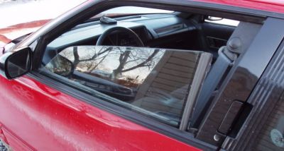

My window was going off track:

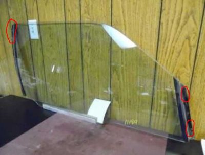

What I was noticing is the window was loose while sliding in the tracks.  The rear of the window would come off the rear track and causes the front window to come off track.
I pulled the window out and looked at the plastic framing of the window.  I noticed "nubs" that were worn down.  It appears these nubs keep the window tightly fitting in the channels.  The rear nub was really worn down and I suspected this is why it would not stay in the rear channel.
I circled the nubs:
GP Window Nubs
My fix was to add material to the nubs and build them up.  Since the frame and nubs were plastic, I used Plast-aid.  I mixed up a small batch and raised the nubs 1/16 of an inch. (btw, get yourself a plast-aid kit-- $20.  You need this when working on plastic stuff)
I put the window back in.  The rear nub actually snaps into the rear channel.  The front fits in the front channel snugly.
I tested the window and it works great.  Stays in track now.
