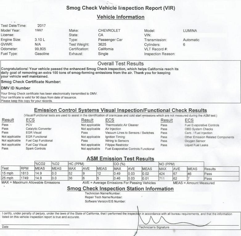

1979lee Posted March 9, 2017 Report Posted March 9, 2017 I just passed my states "smog test" passed great. and my car runs great, but the mpg's aren't very good, and Stinky Exhaust when cold, or after the car sits 30 minutes or longer. smells like i have no cat.(but i do)!. after the cat is warm no stinky. no codes, no rotten egg smell from exhaust no visible fuel leaks. 1997 lumina 3100 V-6 100k. i had the throttle body off last week, checked the egr passage, nice and clear, i didnt remove the egr. but this car i tell you very little/no blowby. very clean inside. in 2014 i did swap in a 2005 impala 3400 tb, so in 3 years and 20k ive had not a problem. sorry if i rambled... any ideas? Quote

Galaxie500XL Posted March 9, 2017 Report Posted March 9, 2017 Hmmm....I'd expect, though, with a misfire, there would be oxygen in the exhaust stream, because of incomplete combustion. I find it odd their test shows 0% oxygen in the exhaust stream...I'd expect at least SOME residual oxygen, even if things were 100% good. Additionally, HC emissions are very low, I'd expect them to be pretty high if there was a misfire. 1979lee 1 Quote
