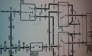

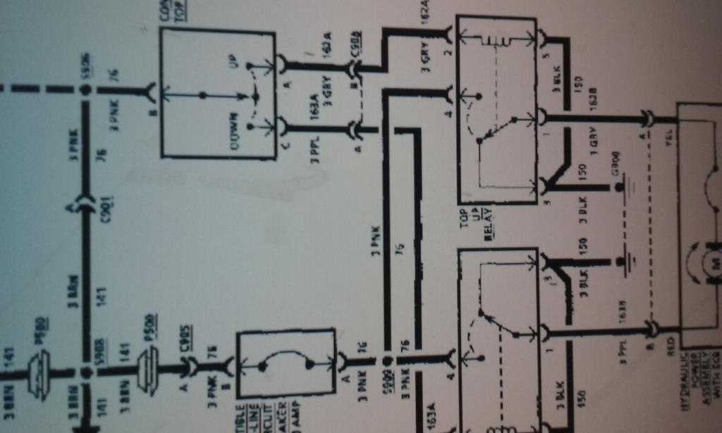

Imp558 Posted March 13, 2018 Report Posted March 13, 2018 Nothing to lose by taking that switch apart and trying to service it. I don't see how it has the ability to run slow due to the switch though. Quote
GabsOlds Posted March 14, 2018 Report Posted March 14, 2018 Well, if the switch contacts have been arc-ing, they have a weld on them, and are not passing all the voltage. This would run the motor at slow speed. You can take it apart and sand the contacts, or replace the switch if you can get one. Quote
Imp558 Posted March 14, 2018 Report Posted March 14, 2018 Well, if the switch contacts have been arc-ing, they have a weld on them, and are not passing all the voltage. This would run the motor at slow speed. Nope, the switch turns on a relay, the relay is what runs the motor. The switch should be passing current in the range of milliamps, not enough for any kind of arcing. I could see a window switch where it was poorly engineered to run the motors directly and then downright asinine where they incorporate a type of circuit breaker to intentionally overload and pop for one-touch-down. My guess is motor or relays. It would be a really good idea to test some stuff with a meter if it hasn't been. Multimeters are our friends. Quote
GabsOlds Posted March 14, 2018 Report Posted March 14, 2018 The arc-ing would be on the relay then. I doubt those contacts are accessible to repair. Put eyes on both cylinder rods to make sure they are both connected to the top. Check the fluid level in the pump to make sure it is on the corresponding level lines. Measure the voltage at the relays, then at the motor leads to make sure 12V reaches the motor. If you are getting the voltage at the motor, then try a new pump. Quote
