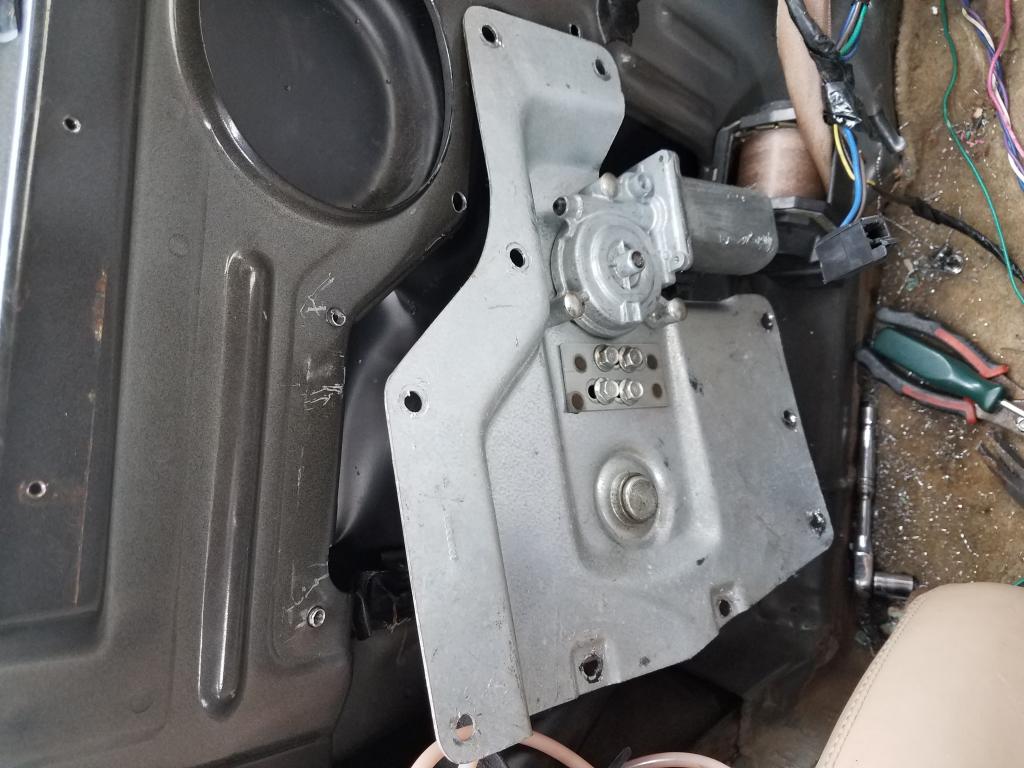

Hello all!! I replaced 1 of my rear windows after car got vandalized. Heres a pic for all 1995 cutlass supreme convertible owners so ya can get an idea of how it looks behind the 95 trim. Hope this helps. Almost positive its the same setup for the 90-95 verts. To remove panel you need to remove metal rivets and you will need a rivet gun to install the window motor panel back into place
So to change the rear side window motors you have to drill out a riveted panel? Damn.
  • Like 1

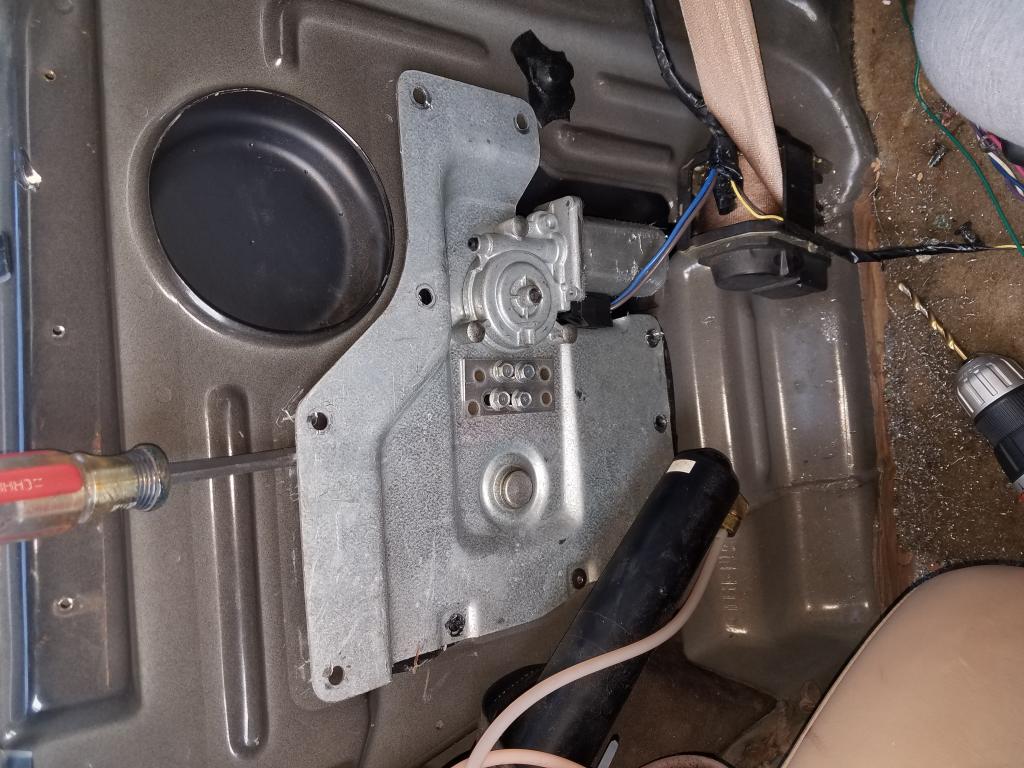

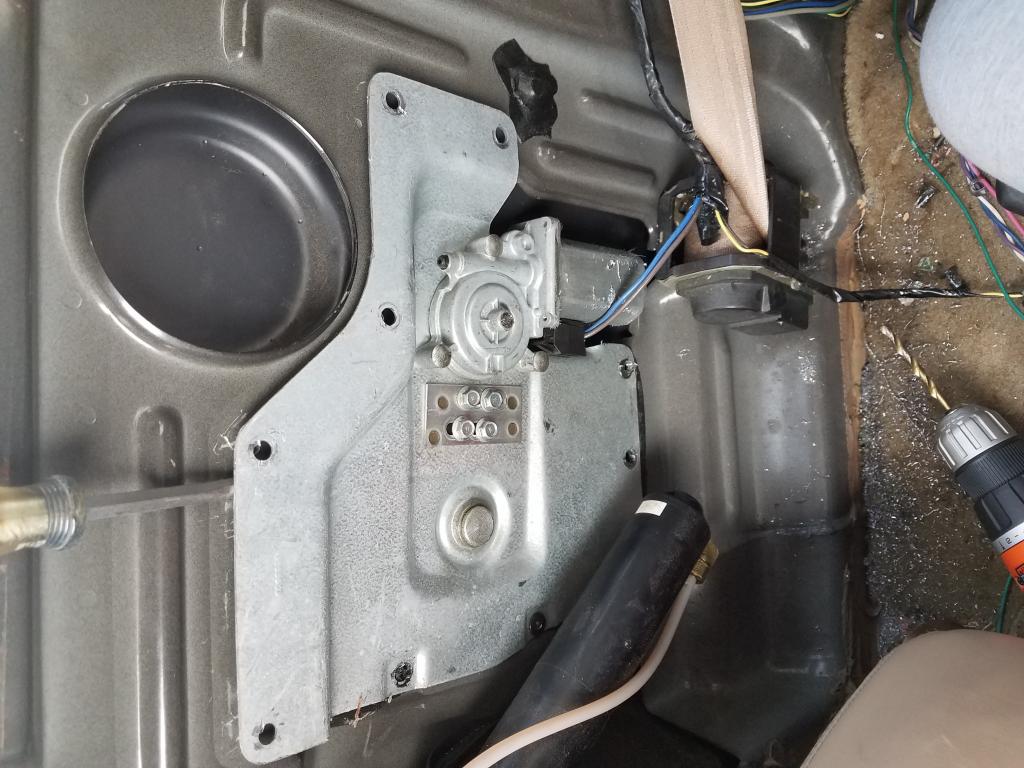

Yup. U will need a small chisel or phillips head and a drill. Oh and lots of patience lol
Rivet gun sir ;)
Did you take pictures of that? I have to do the same thing to a 94 Cavalier, but to swap out the window motors.
Unfortunately i did not sorry. However youtube helped me big time on how to use the tool.
