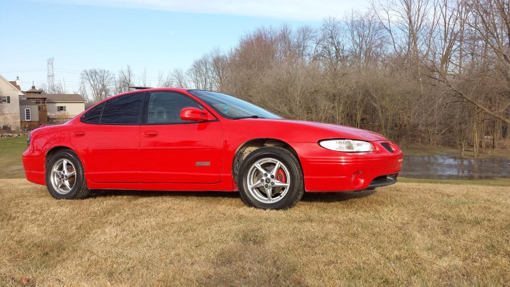

94 olds vert Posted April 1, 2017 Report Share Posted April 1, 2017 Here you can see the old 10 inch rotors. Quote Link to comment Share on other sites More sharing options...
Grandprix1 Posted April 1, 2017 Author Report Share Posted April 1, 2017 Oh wow yes that's a difference haha Sent from my iPhone using Tapatalk 94 olds vert 1 Quote Link to comment Share on other sites More sharing options...
94 olds vert Posted April 1, 2017 Report Share Posted April 1, 2017 Nice that's kinda what I was hoping for. I bought the kit so it's got powder coated calipers. I'm only getting the rears just so everything matches Sent from my iPhone using Tapatalk The 12inch rotors, and new pads really helped the stopping power. The dual pistons calipers should really anchor the car down. I am looking forward to getting mine on. Quote Link to comment Share on other sites More sharing options...
Grandprix1 Posted April 1, 2017 Author Report Share Posted April 1, 2017 Yeah If you get them on before I get mine on let me know what you think. Everyone says it's night and day difference Sent from my iPhone using Tapatalk Quote Link to comment Share on other sites More sharing options...
