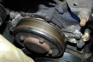

95GS Posted November 23, 2016 Report Posted November 23, 2016 Had a lower rad hose leak (broken clip) so taking this opportunity to change hose and home flush the system since I had read here the problems of mixed green & orange coolants. There's a fair bit of corrosion on the water pump exterior. When spun by hand it makes a kind of rattle noise in the clockwise direction, smooth & silent when spun anticlockwise. (Have not looked at the weep hole w/ mirror (Haynes recommendation), will do so in the morning.) Are these signs the water pump needs changing? Does the pulley need to be removed first? Any other things to look out for? Elsewhere Schurkey mentioned engine block drain holes - what do they look like? Quote
Nas Escobar Posted November 24, 2016 Report Posted November 24, 2016 Loose pulley would probably get a new pump in my book. I'm not a big fan of anything loose. That corrosion could be from the elements, but if the seal was going bad, you would see the pump wet at its surroundings. If you were to change the pump, it would be easier to remove the pulley with the belt still on it opposed to off the car, HOWEVER you don't need to necessarily remove it to get the pump off. You will be using the old pulley on the new pump so long story short, take it off before working on the pump itself. Quote
95GS Posted November 24, 2016 Author Report Posted November 24, 2016 Loose pulley would probably get a new pump in my book. I'm not a big fan of anything loose. That corrosion could be from the elements, but if the seal was going bad, you would see the pump wet at its surroundings. If you were to change the pump, it would be easier to remove the pulley with the belt still on it opposed to off the car, HOWEVER you don't need to necessarily remove it to get the pump off. You will be using the old pulley on the new pump so long story short, take it off before working on the pump itself. Thanks Nas. I'm in agreement about loose things. Don't think it's loose, just a little rough turning clockwise, smooth going anticlockwise. I ordered one along with a new hose. The initial draw was a slow coolant leak which was coming from the lower hose, because the clamp had broken. Although broken in two, it still clung tight to the hose, embedded so to speak. Yes, could be environmental corrosion, no sign of moisture. Leaving the belt on to remove the pulley - Good tip! Is there a preferred type of clamp for rad hoses? A regular stainless hose clamp? The OEM type is tough to deal with in tight spaces. Quote
Schurkey Posted November 25, 2016 Report Posted November 25, 2016 Any roughness to the pump is cause for removal and inspection, likely replacement. I admit I'm curious what could be bad that it's only rough one direction. The OEM clamps--which I used to despise--are in fact wonderfully engineered; especially the newest versions that are self-locking when squeezed-open with pliers. Then, when you're ready to clamp the hose, just position the clamp and tap the locking mechanism, and POW! they spring shut and tight. Couldn't be better. OTOH, the worst clamps I see are the ones I used to favor--the cheap "Breeze" clamps with the worm gear and a bazillion slots in the band. The rubber of the hose extrudes (cold-flows) through the slots. At least use a SHIELDED clamp, so that the rubber doesn't squeeze out through the slots. Yes, they cost more. l67ss and rich_e777 2 Quote

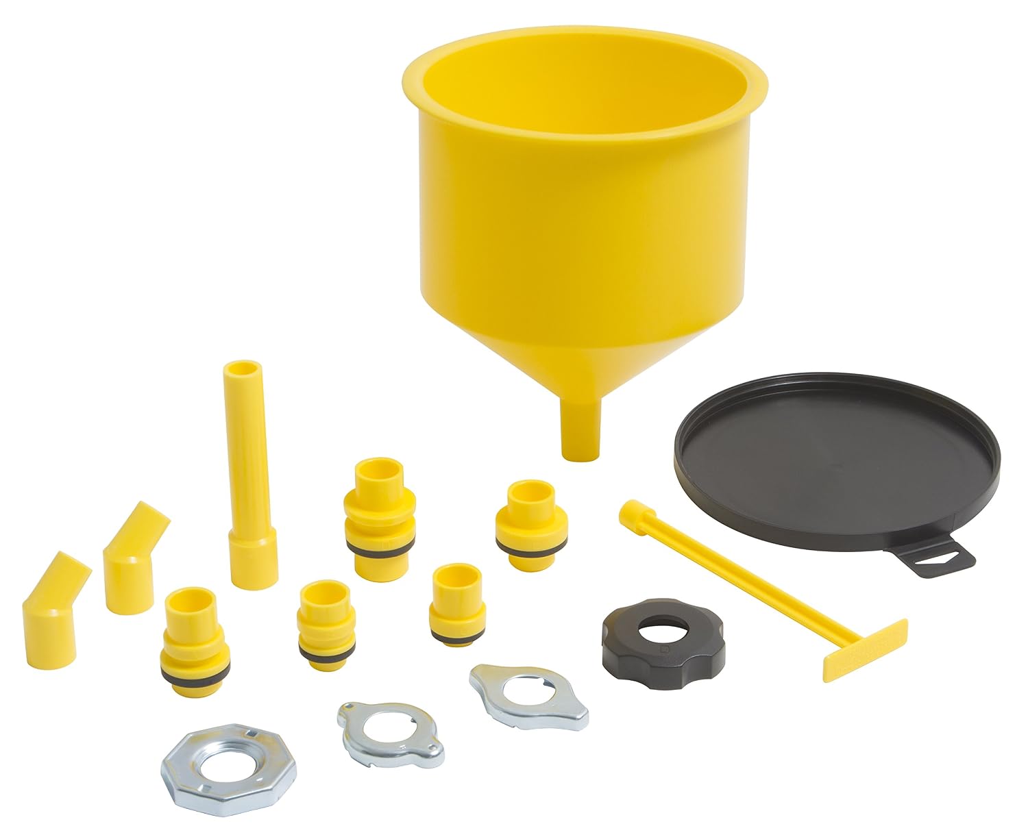

Schurkey Posted November 25, 2016 Report Posted November 25, 2016 How much below the high-point of the cooling system is the radiator cap? I would be filling the radiator using a tall, sealed funnel. Fill the radiator so that the funnel is about half-full. Open bleeder valves as required with engine at fast idle. When the thermostat opens, the fluid level in the funnel will drop--and surge, and spit-back. Add liquid as needed to keep some coolant in the bottom of the funnel. As the engine warms up, the level in the funnel will raise. Then the fans come on, and the level drops a bit. When it's all reasonably stable, and there's no more air at the bleeder screw(s), use a fluid suction device to empty, and then remove the funnel, and put the rad cap back on. Then you can shut off the engine. Don't forget to remove the overflow bottle, fill it 1/3 full of sand and then add 1/3 of HOT water and some detergent. Shake the shit out of it. The sand scrubs the inside of the plastic, and then dump the whole filthy mess. Rinse several times with HOT water, and reinstall. Fill the overflow bottle as needed with your mix of water and antifreeze. Test the rad cap to assure it holds pressure. https://www.amazon.com/Lisle-24680-Spill-Free-Funnel/dp/B00A6AS6LY/ref=sr_1_1?ie=UTF8&qid=1480055061&sr=8-1&keywords=Lisle+coolant+funnel rich_e777 1 Quote

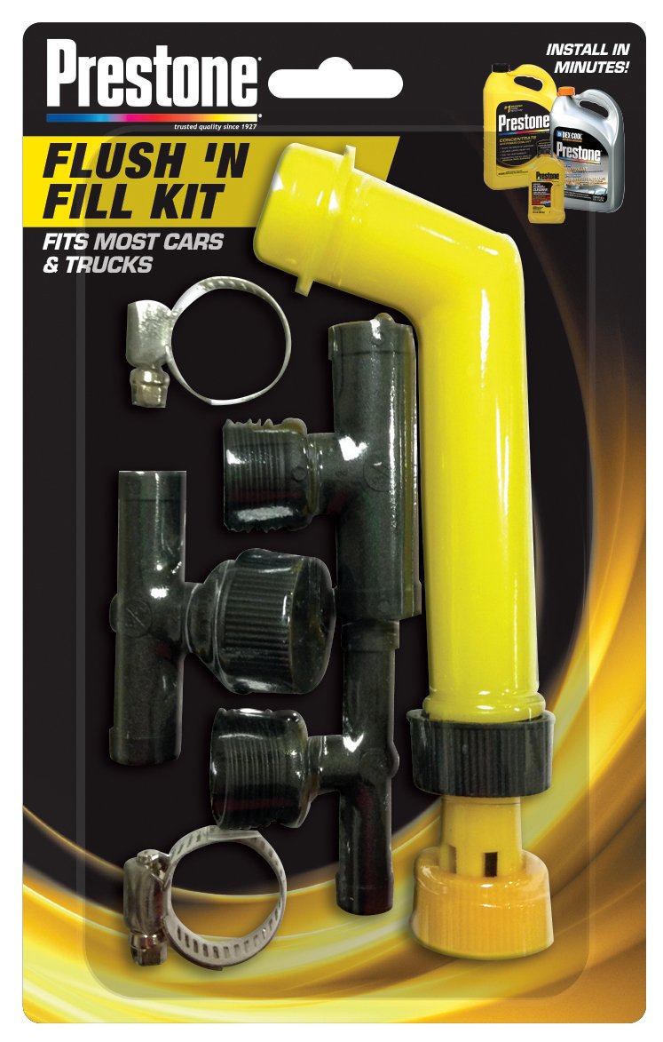

Schurkey Posted November 25, 2016 Report Posted November 25, 2016 Well, on second thought, you're using a Prestone product to clean the cooling system, therefore you're planning to flush the coolant. I use a flush kit like this. They can be had locally, or from Amazon just like the funnel. Amazon shows $9 now, the last ones I bought were $4. 'Course, I haven't bought one for three years. Install the nozzle into the rad cap flange, install the appropriate-size Tee into a heater hose (return hose preferred, but I'll take what I can get.) Connect garden hose to Tee, turn the water on "full blast". Start engine, work the throttle for both high and low RPM while watching the nozzle. When there's no trace of coolant coming out...you're done. Leave the Tee in place with the cap to seal it. Remove the rest. Ideally you'll have the block drains pulled, too--but if not while flushing, then afterwards (If the engine has block drains.) https://www.amazon.com/Prestone-AF-KIT-Flush-Fill-Kit/dp/B000CCFY5W/ref=sr_1_1?ie=UTF8&qid=1480056082&sr=8-1&keywords=Prestone+flush+and+fill BEWARE: Unless you've pulled BOTH block drains, you DID NOT empty the block. The block drain plugs--IF THE ENGINE HAS ANY (some Buicks did not) are likely to be either steel pipe plugs, typically with a 3/8 hex head, or a steel plug and a knock sensor. GM often but not always crammed a knock sensor into the block drain hole on one side. I have a habit of replacing steel plugs with brass from any home improvement store--plain ol' 1/4" pipe plugs except for Pontiacs which tend to use 1/8" pipe plugs. Yes, there's a really good chance that you'll pull the plugs out and NO COOLANT WILL COME OUT. Jam a Phillips screwdriver into the hole to break-through a crust of rust and scum, garf and garfelderfarb, and then the water pours out. If you flush the system, and you don't pull (or have) block drains, you will have some amount of pure (tap) water in the water jacket of the block. Look at your owner's manual for cooling system capacity, figure out how much is 1/2 the capacity, and you'll know how much anti-freeze to use. Be sure to put the PURE anti-freeze in first, so you're sure to get all the freeze/boil/corrosion protection you think you have. I mix DISTILLED water into the antifreeze AFTER the appropriate amount of anti-freeze is in the engine/radiator/hoses/overflow bottle. This means--if you're lucky--that fancy funnel I had you buy in the previous post will have only water in it--aside from whatever amount of coolant spits-back as the air works its way out of the cooling system. Quote

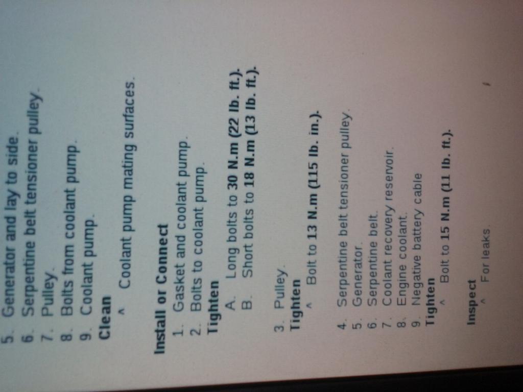

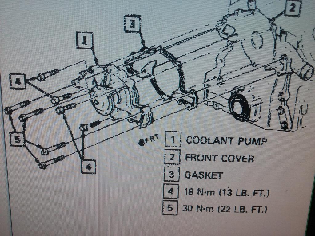

95GS Posted December 1, 2016 Author Report Posted December 1, 2016 Water pump bolt torque Haynes says:- short bolts: 132 in. lbs, step two - additional 80 degrees long bolts: 22 ft. lbs. Could someone confirm this for me? Quote
Imp558 Posted December 1, 2016 Report Posted December 1, 2016 Here's Alldata, I'm sending another pic up in a minute Quote
95GS Posted December 1, 2016 Author Report Posted December 1, 2016 Terrific - thank you! Imp558 1 Quote

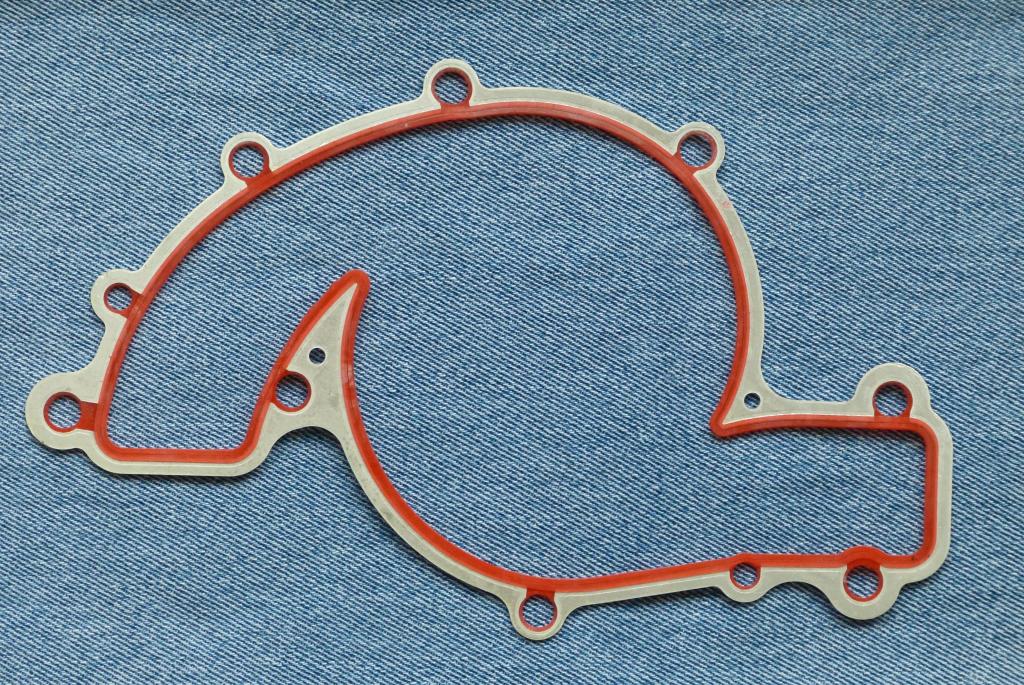

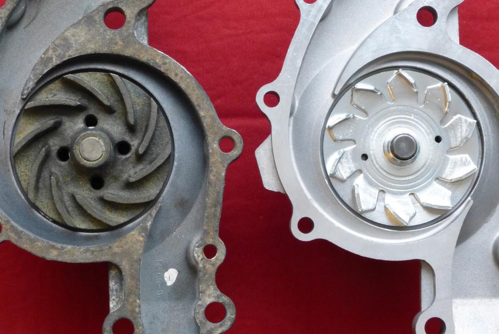

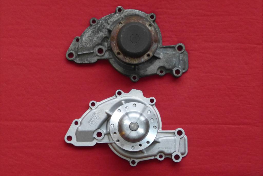

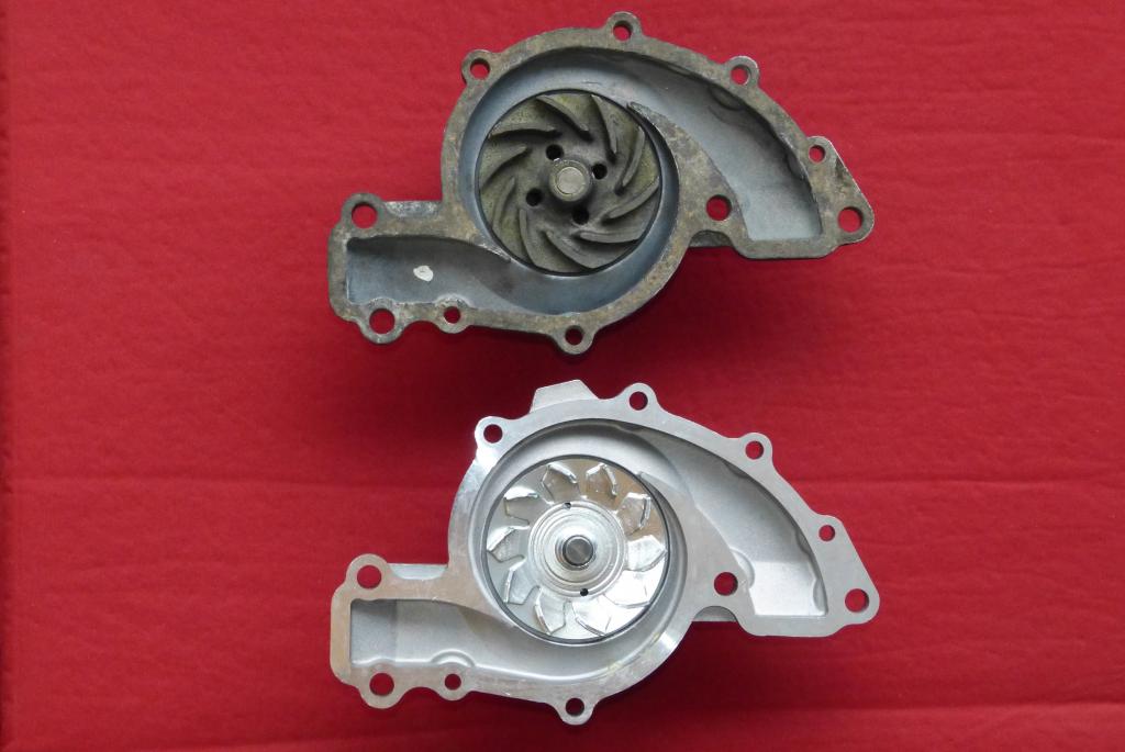

95GS Posted December 2, 2016 Author Report Posted December 2, 2016 For the record, old water pump & new. Looks nice and shiny, nifty metal gasket. Made by Gates...in China.. Unfortunately, the impellers are quite different.. The Gates pump was $63 CDN from Auto Value. The GM model is $275 CDN, (~$200 USD) but haven't seen it. How do these pump impellers compare with your experience? Quote
Imp558 Posted December 2, 2016 Report Posted December 2, 2016 Wow, what a difference in impellers. Makes me wonder how hard it would be to put a new bearing and seal in it. Quote
95GS Posted December 2, 2016 Author Report Posted December 2, 2016 Wow, what a difference in impellers. Makes me wonder how hard it would be to put a new bearing and seal in it. Yes, I thought along those same lines. It's installed now, but I doubt it will move fluid like the old one. If I'd had luxury of time and some forethought, I might have shopped around for another model or for a machinist who would know how to switch impellers without wrecking the bearing & seal. The shaft seems to be the same diameter. A Cuban taxi driver would know what to do. The old pump (made in Japan) was likely installed at a GM dealer, habit of the previous owner. Quote
