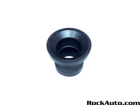

ron350 Posted September 28, 2016 Report Posted September 28, 2016 This probably won’t help. Rockauto under Transmission / Seal / Oil filler tube seal. Probably Pioneer 7600145. Quote
GabsOlds Posted October 16, 2016 Report Posted October 16, 2016 This probably won’t help. Rockauto under Transmission / Seal / Oil filler tube seal. Probably Pioneer 7600145. This is probably rubber, since it's a seal. But my heart skipped a beat when I saw the picture! It looks just like the convertible top lock pin guide! Quote
