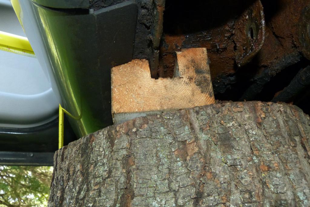

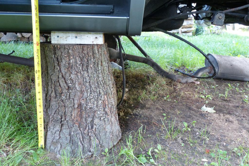

95GS Posted October 10, 2016 Report Posted October 10, 2016 I will post a photo of this later tonight or tomorrow. My apologies for missing that deadline(!). Posting photos is not habitual, but I realized that my pics were crossmember related, not your focus or an answer to your question So I took these a few days later to show it could be a home job - my front end on ramps, rear on logs @ 17" high. The white block is a 4 x 4, channeled-out to spread load & avoid deforming any weak steel.
W30olds Posted October 12, 2016 Author Report Posted October 12, 2016 Thanks for sharing! I'm going to have my local shop do this repair. I don't have the correct tools or air compressor to use on the shock bolts. He's only charging me $120 to do this and the replacement KYB''s while he's back there. Plus he will have it done in a day. Thanks for your help!
