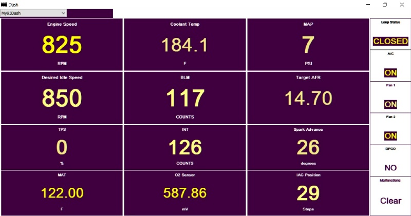

Padgett Posted August 28, 2016 Report Posted August 28, 2016 So possible but not easy/cheap. Figure $120 (Moates ALDL cable and TunerPro RT software. and a Laptop or Tablet to do anything you want. I prefer a PC since can look at many parameters at once. Quote

RobertISaar Posted August 29, 2016 Report Posted August 29, 2016 i've personally released very detailed files for use with tunerpro to play with the 94-95 3100/3.4RWD calibrations, everything except for the flashing program itself(which I don't possess the rights to). the tunercat TDF was extremely bug filled last I looked, so I can't recommend that until it's dealt with. Quote
Imp558 Posted August 29, 2016 Report Posted August 29, 2016 I use Tunercat all the time with a homebrew rs232 interface. It's worked fine for years for me. I've never done a V6 with it though. My old Tunercat OBD II interface has a bunch of 3800s under it's belt, it's a pre-Jet unit. Quote
